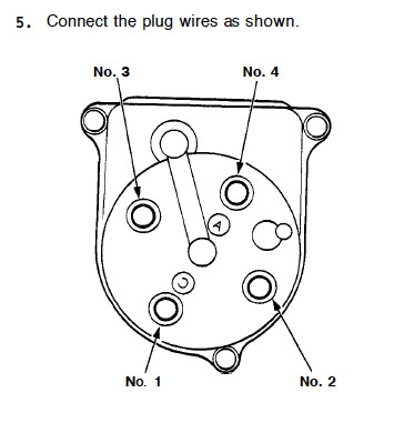

Are your spark plug and fuel injector wires installed in the correct firing order?

yes fuel injector wires are right wuts the order for the plug wires on the distributor?
Old Jul 18, 2009 | 09:21 AM
Cylinder order is 4-3-2-1 from distributor to timing belt.

ok so that is right also... let me put the distributor back in i just bought new cap and rotor.... let me see what happens wut else might not let it start?
