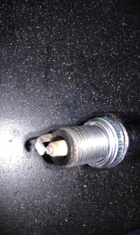

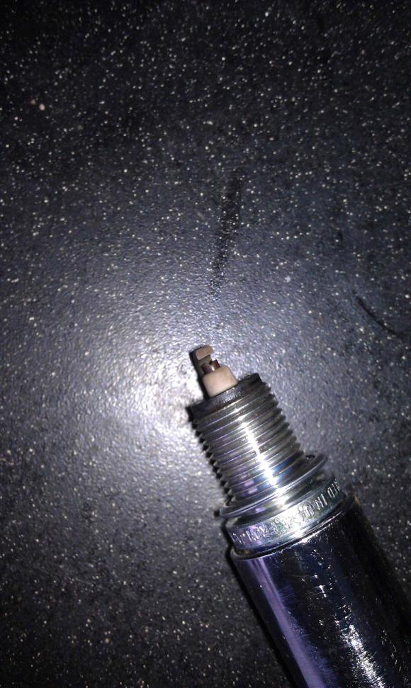

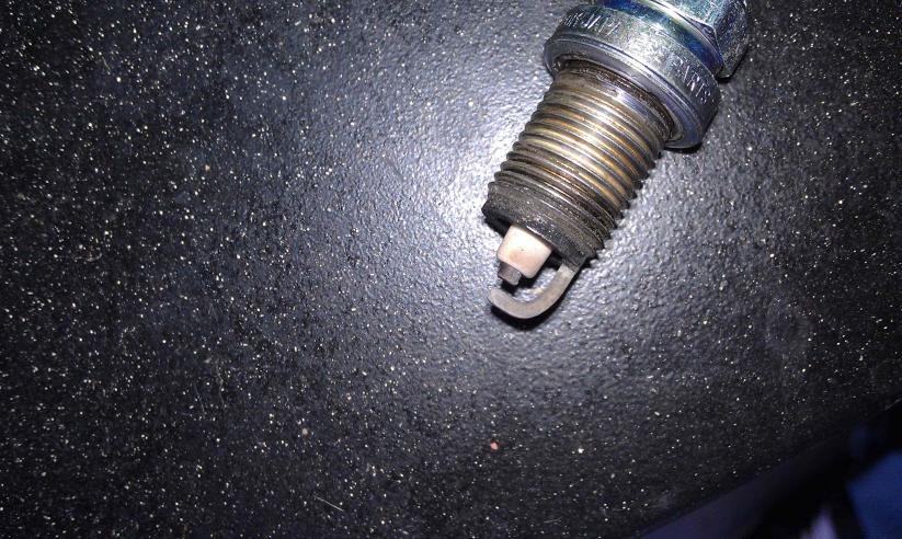

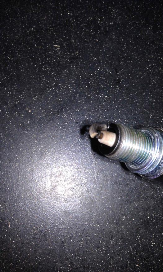

Old Jan 11, 2012 | 02:26 PM
puckman1325's Avatar
Joined: Dec 2011
Posts: 9
pulled out plugs

white smoke usually means coolant if i recall correctly, so it has to be getting into the cylinder somehow.
that said, the second pic looks really lean but could be the flash, and the fourth pic looks a bit lean on the very tip, is all I see there.
