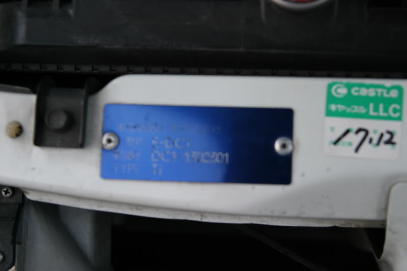

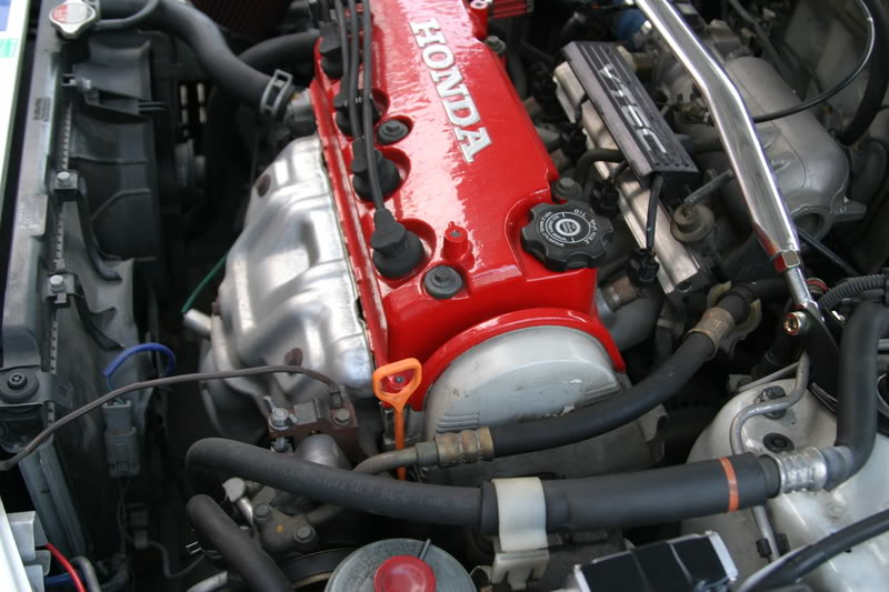

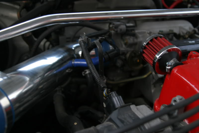

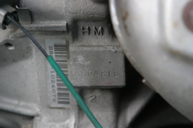

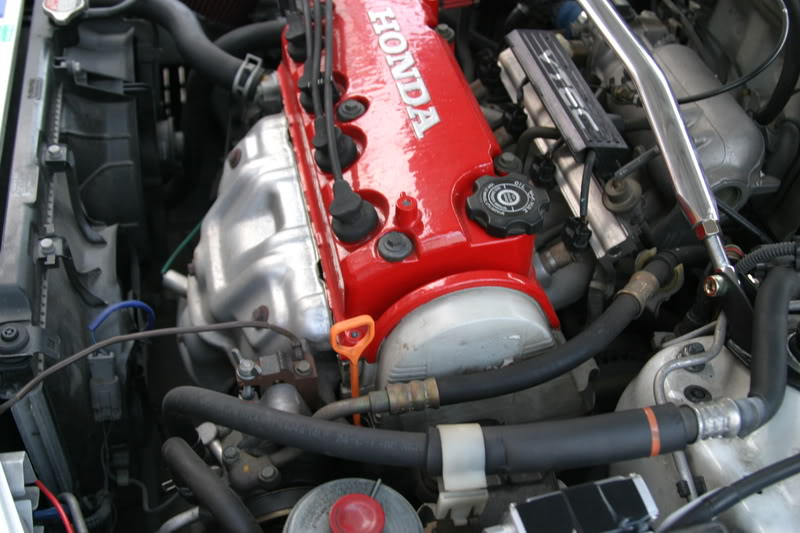

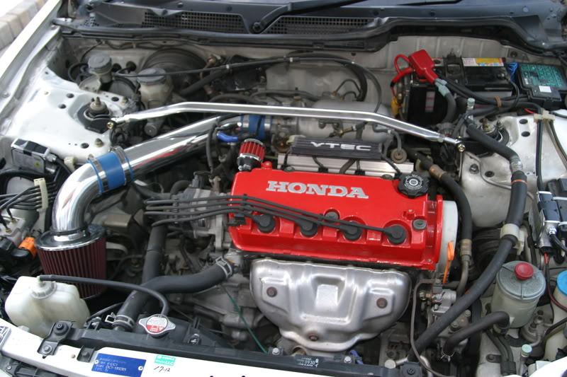

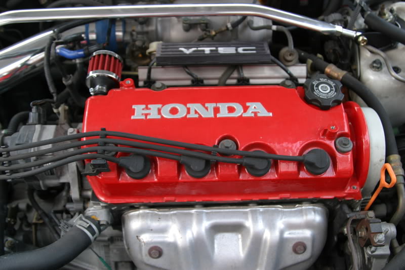

hi i have been searching and searching through the integra forums but no one has the knowledge i need. i have an integra dc1 and my mate has a civic coupe with a d16y8 sohc vtec. i have a zc engine but it looks identical to his besides the vtec solenoid. i want to put the d16y8 headon my car to gain a vtec but i dont know if i can with a zc engine. mine is meant to have 118 bhp but it doesnt feel like it compaired to his car.could some one help me with this
thanksa lot
much appreciate your help
here are pics ofmy engine to help
*pics its not a vtec only paint

you can put the y8 head on the zc, just need to wire up vtec and run a vtec ecu

the only thing that worried me was i read somewhere that the camtiming is more agressive on the dc1 zcintegra engine then the d16y7 thats why they have more power, 118 vs 106 bhp. i knowthe dc1 zc comes with the d16y8 intake manifold is that why it has 12 bhp moreor are the cams different?

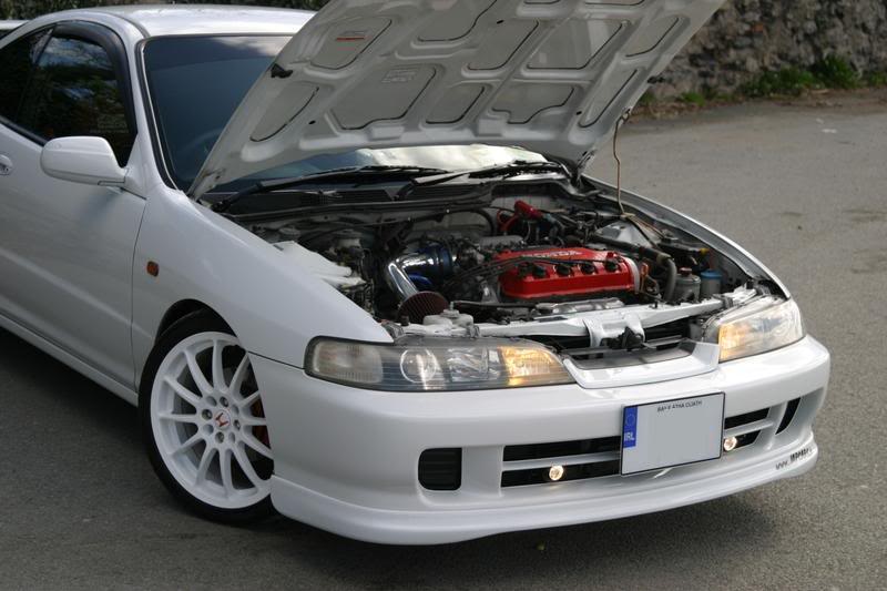

Do you have a pic of the car itself... i'm curious about something
