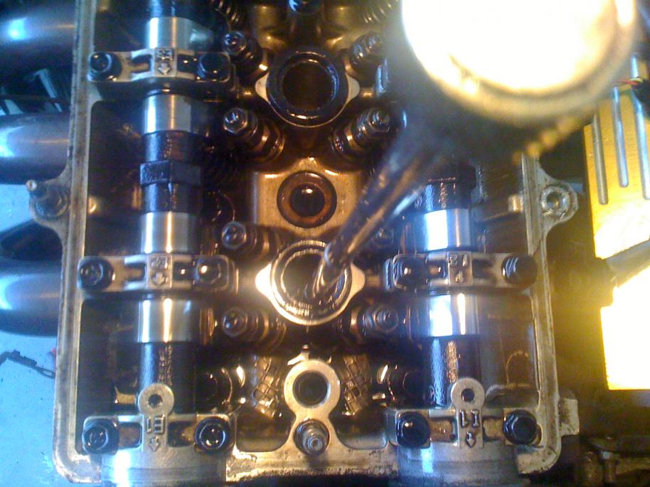

how do i put a pic in this thread lol. i put in spark plug #1 the one closest to the cams. the rest are still in.
Old Dec 15, 2010 | 01:43 PM
DjHagios's Avatar
Joined: Dec 2008
Posts: 165
From: florida/slowcala
this is the spark plug out

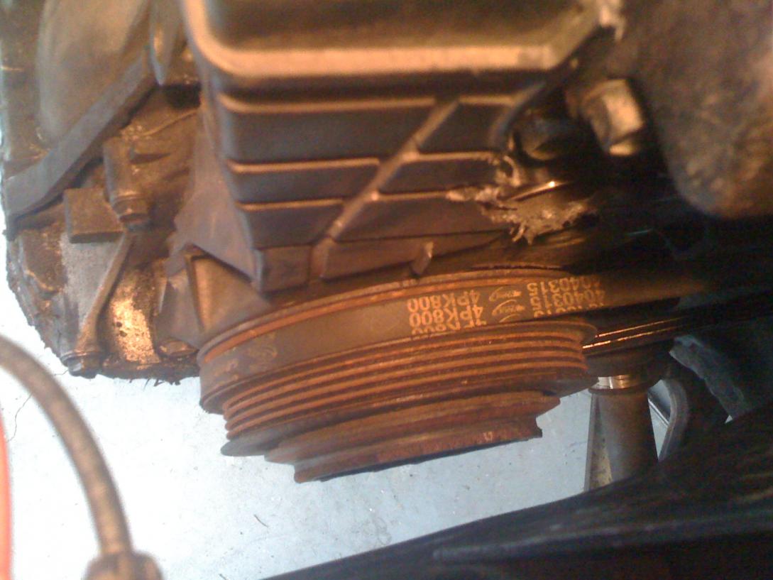

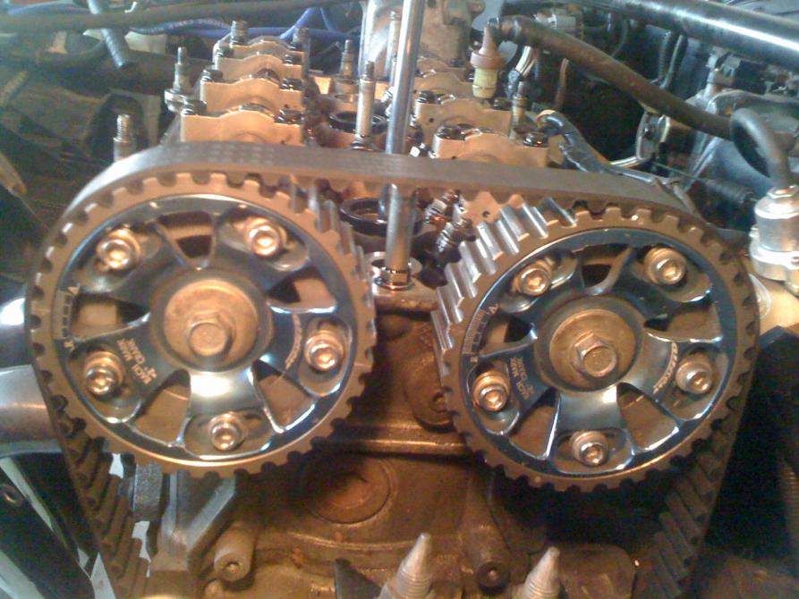

one is the cams and the other is the mark for the pully at tdc. let me kno if i took them wrong.
Attached Thumbnails need help timeing-img_0267%5B1%5D.jpg   need help timeing-img_0266%5B1%5D.jpg

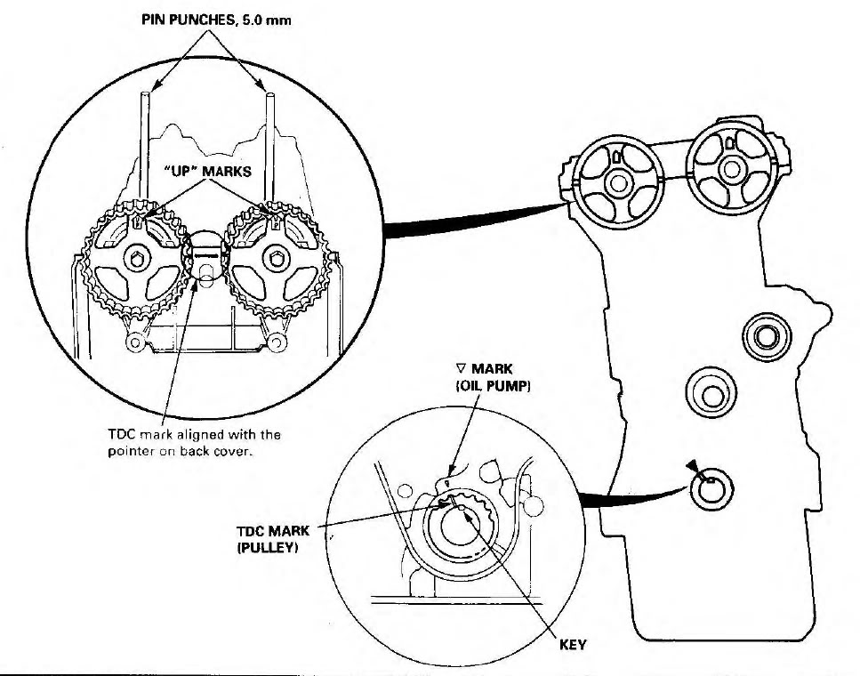

The engine is definitely out of time.
Do you have aftermarket cam gears?
Are you missing the back cover?

yes i do have aftermarket cams.i jus dont kno what mark on them is TOP. set at 2+/- degrees on both.and no i dont have the back plactic. i bought the engine not to long ago. so i dont kno much about it and or what they had it tuned for. i had to do the TOB and timing. where can i fin those pin punches that would help out alot.
