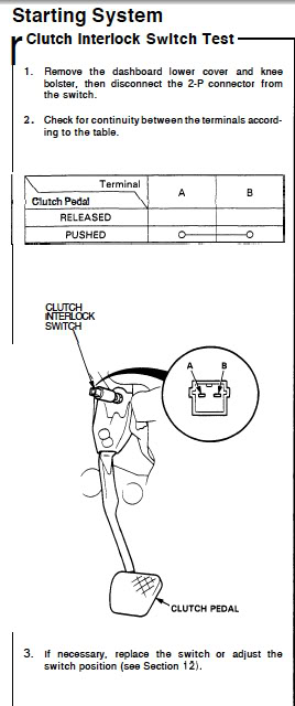

Start by testing the clutch interlock switch and the ignition switch:
