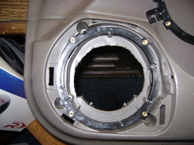

jus intalled my eg9 corners. the all clear ones..now trying to install some alpine spr-17c into my car. but they dont seem to fit. they are 6.5. might have to do some cutting in order for them to fit.
I installed the same speakers in my Civic, SPR-17c. They are not "direct fit" like the entire internet says. I had to cut the panels a bit and use those black rings from the package.

Thats how they work in an EK at least.

iight. mines are goin in the rear for now. but ill try that 1" spacer and see if that lets me screw down the speakers. if not. imma have to cut around the speaker hole so the speakers sit flush. thanks

I recently installed SPS-17's; trimming was needed, I didn't use the adaptor rings however, just piloted new holes. You may get moisture on the back of your speakers, I did, and the plastic moisture barrier in the door doesn't protect the speakers.
I installed foam baffles behind the speakers, keeps them dry, but sound suffered a bit. I'll be cutting a hole in the bottom so they can draw more air and see if that helps the sound.
