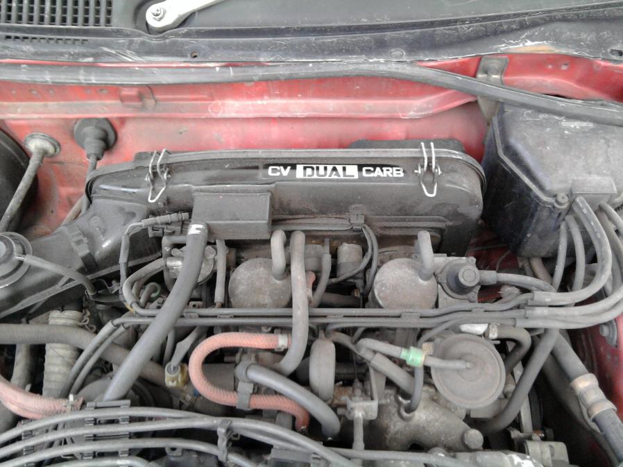

Old Sep 17, 2010 | 06:58 AM
does it say dpfi on breather? take pics and post pics of the motor

1.5 dual carb to 1.6 doch vtec.. trouble :P-photo0200.jpg dual carb is on it
Old Sep 18, 2010 | 07:06 AM
hmm thats a first ive seen a civic with dual carbs, but to answer your question i suggest selling it and getting a fuel injected model, because to do a swap your gonna need alot of stuff, your gonna need to replace the whole fuel system and also you will need to do a crap load of rewiring, just to get it to fuel injection, then you gotta spend $$ on the b16 motor, mounts, trans, wire harness, axles, shift linkage, ecu just to get it to work.
