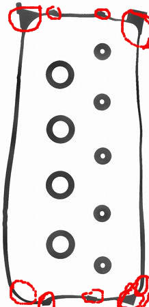

Does a new valve cover gasket need to be used when the valve cover is reinstalled?

Recomended but not required. Be sure to apply a dab of RTV silicon to the corners of the gasket prior to re-installation.
A-like so.....
