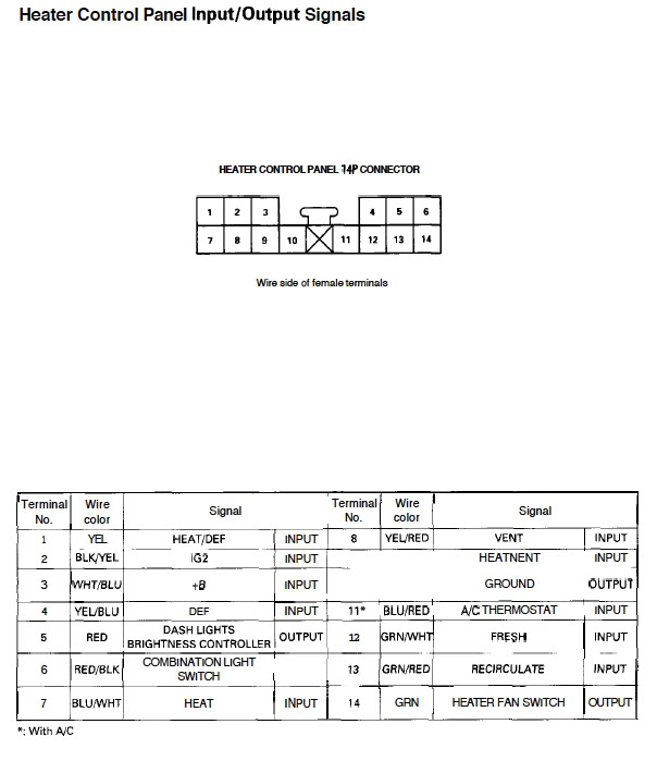

I agree with what mk says, although 96-98 Civic heater control panels don't include a self diagnosis function.
Did you check BACKUP fuse 47 with a multimeter? Did you try replacing it?
The WHT/BLU wire from the BACKUP fuse pins to terminal 3 of the control panel connector. As mk recommended, check for battery voltage to ground at this terminal. If you have battery voltage, then you probably fried the control panel circuit board when you wired your remote start system. In this case, you'd need to replace the panel to regain the memory function.
