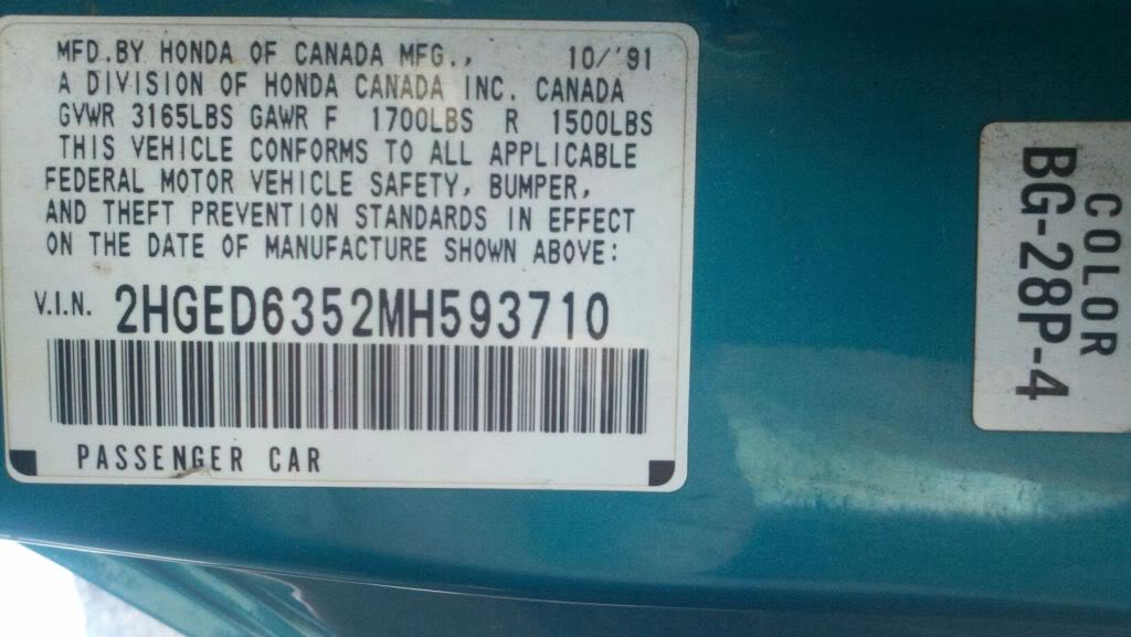

Ive done hours an hours of research and cant find a '91 thats a 1500s

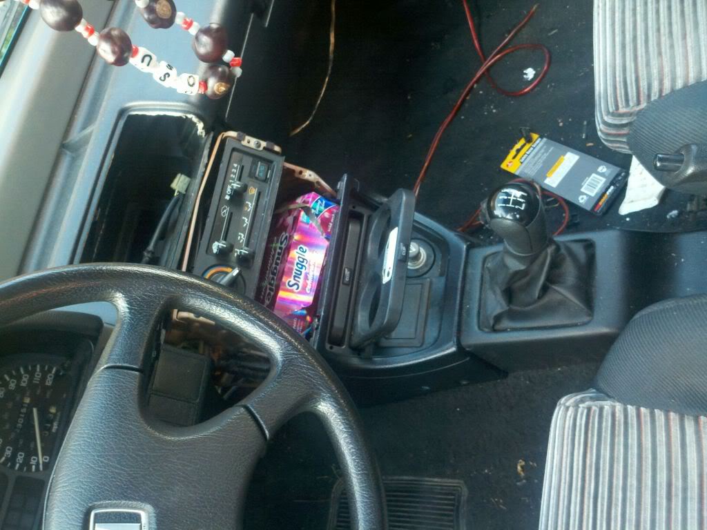

And the steering wheel says "real time 4wd"

It would be the first EF I've seen with 4-wheel disk brakes. Never heard of the S model, though... the "1500" would refer to the displacement (~1,500cc).
*edit: 4wd should have a 1.6L though. I'm still doing some digging though.

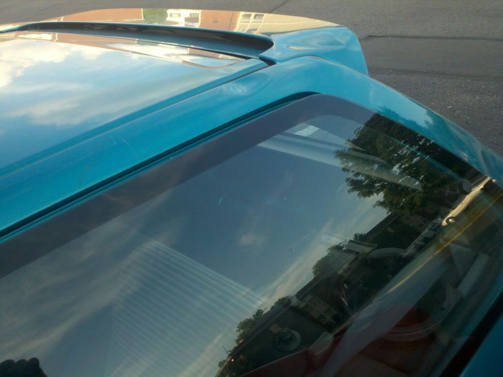

Possibly just a replacement hatch from a previous generation? The third generation had a 1500S model and the body style wasn't too much different.

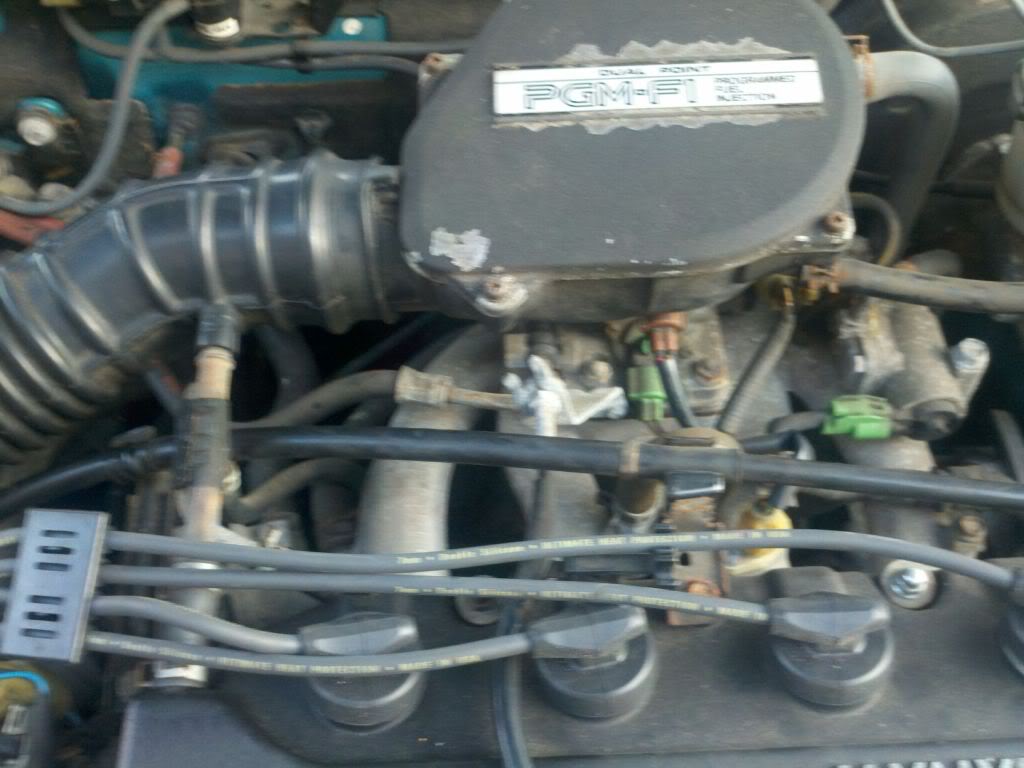

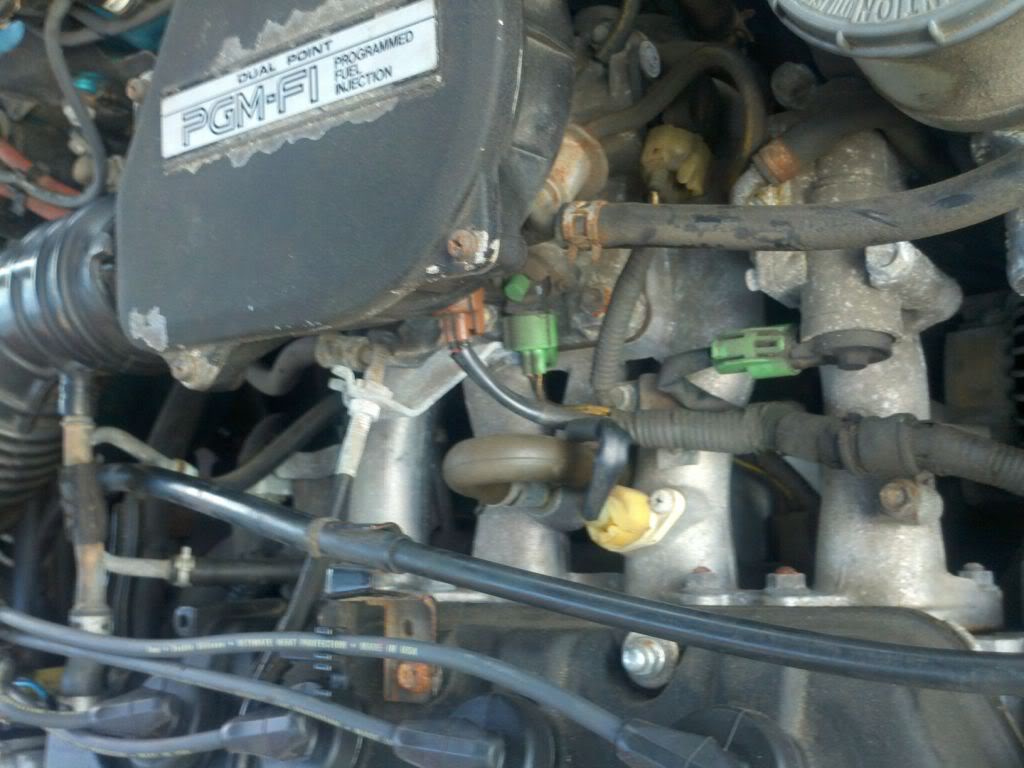

Notice anything different about the motor? Is that the original d15 and original head?

Engine looks just like mine, totally stock D15B2 with DPFI. I like that coolant bleeder bolt, but the first thing I'd do under the hood is run that #4 spark plug wire underneath the others instead of looping over the top.
