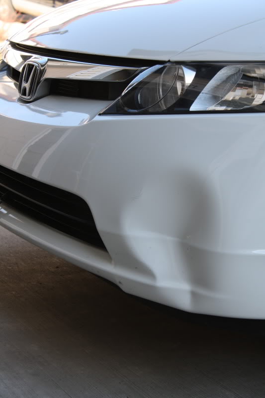

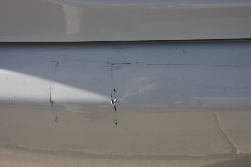

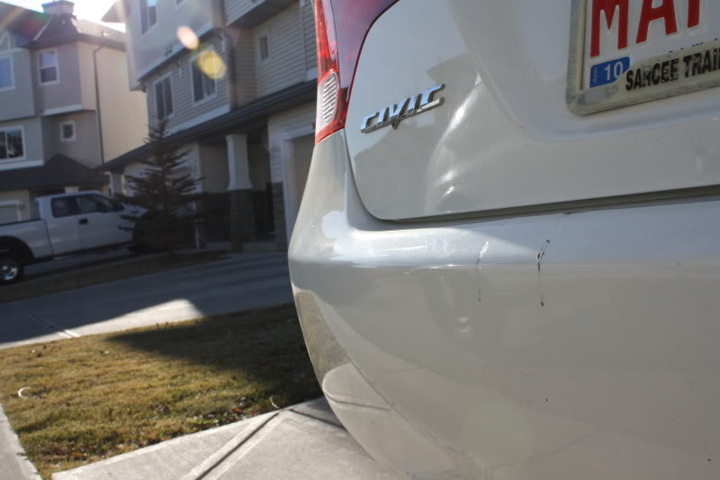

I hurt my car yesterday in a bizarre accident (it was parked in the garage, my other car hit the garage door bumping my civic forward into a dog kennel). Both bumpers are damaged. The front bumper has a dent and the paint looks cracked where it bent in. The back bumper has an actual crack (1.5 inches) in the bumper and some of the bumper is ripped, as well as paint damage (this is from the metal joint on the garage door). :hithead:
Anyways I am looking for some advice on where to have this damaged repaired for a reasonable price (bodyshop? dent place? buy a new bumper?)

Well you could probably pop that front one, but it probably will leave some signs that it was damaged. The back one is obviously cracked. Any reputable body shop will be able to fix this.

^ditto pop the front out get the rear fixed by a shop

Use a hair dryer to CAREFULLY warm the front bumper. If the hair dryer has a little button for cold air, that's a major plus. Alternate between warm and cold or warm and off so you don't burn the paint, and then reach around from underneath and pop it out. If you warmed it well enough (BUT NOT TOO MUCH), there will barely be any signs that it was damaged.
The back bumper is cracked so it'll have to be fiberglassed or something. That or replaced. With it being a pretty new car, a replacement bumper won't be cheap and painting it to match will hurt a bit too. Probably easier to have a shop repair that bumper and then repaint. Pretty much any reputable collision repair shop will work.

I wouldnt take it to a shop, there are a lot of mobile vendors that can fix this onsite, the damage really isn't that bad, I did taht to my benz once before took a couple hours and about 200 bucks and it looked as good as new. Pretty good company I've used is colors on parade, they have a lot of locations across the US, I don't know where your at, either that or look for mobile bumper repair on craigslist.

if the dent was a bit smaller id tell you to grab a plunger and pop it out, my friend did that on his gti lol, it worked but obviously thats too big.

just do what wellfedhobo said, warm it up and reach behind it and push it back out
