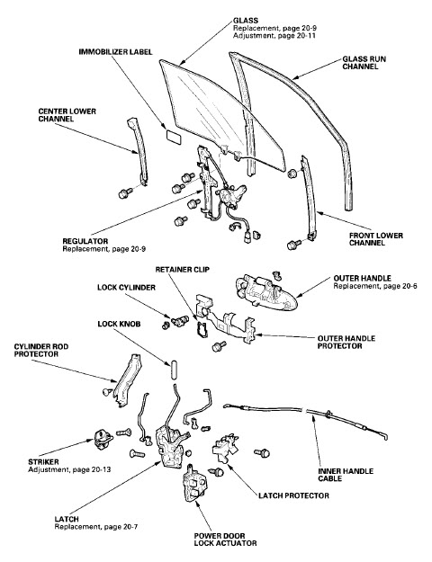

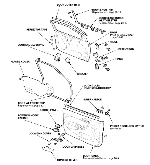

Ok! Today I try to open the driver door with my key,and it will not unlock the door.I have a 2004 honda civic 1.7L engine.I would appriate if anybody can direct me to the proper repair and precedure.Thank for your time,and hope to hear from somebody.

Your probably gonna need a new lock. But to take it out, you need to take off the door panel. Then remove that plastic piece, and you will see the lock behind the door panel.
Old Jun 22, 2008 | 09:15 PM
Default RE: driver door tumbler
For more details, see 02-03 manual at link below.
