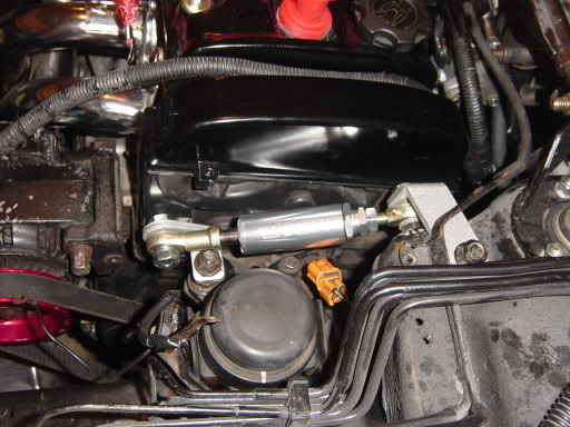

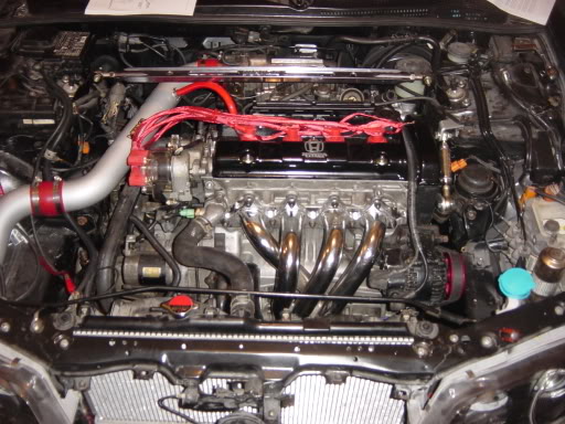

its bolted to the right side engine mount and to the large bolt on the shock tower. best pics i could find on a quick search

i woulda spent the extra ~$50 on an NRG one..
