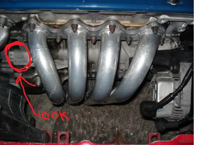

Where can I look under my civic si for the type of motor code it has like B16A1 etc.
Its from canada and is a SOHC.
Old Sep 17, 2009 | 11:07 AM
look where the block and trans meet just to the left of the exhaust.

thank you very much. knew it was in the area but i couldnt find it. mine was just so faded :P

just post a pic of your engine entire engine that is, if you said it was a canadian si and it was a sohc 99% chance its a D16Y8. Really doubt someone would swap in a diff sohc unless they went z6
