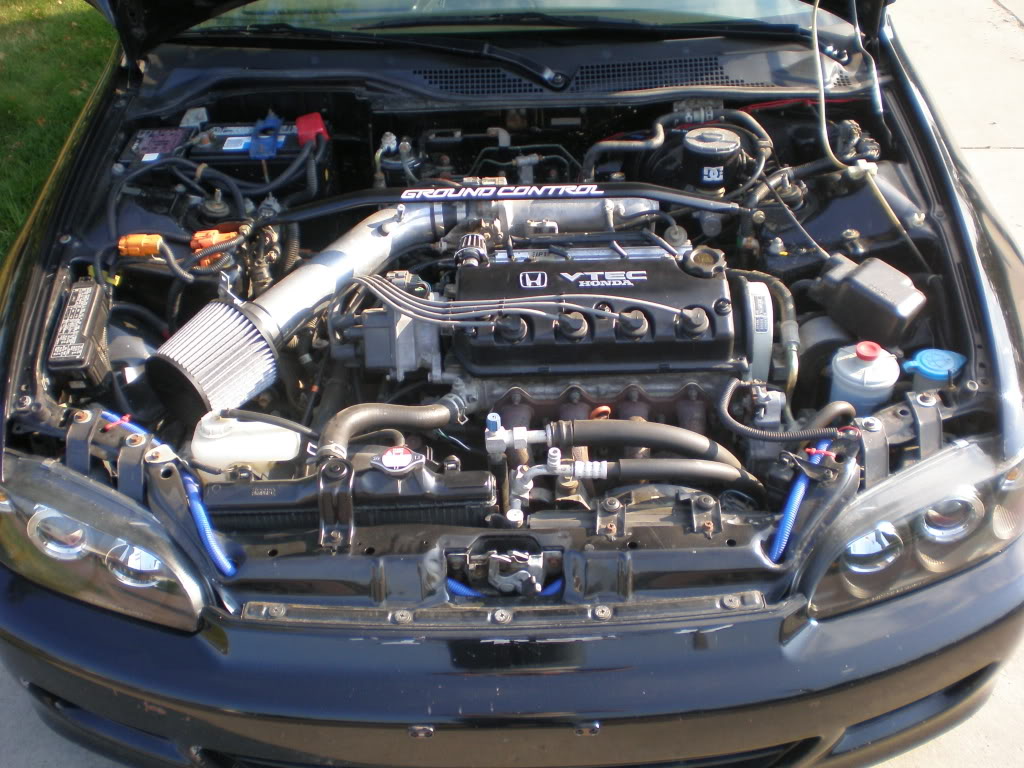

Breather filter, plug the hole in the intake, use the tubing that came with the intake to replace the second hose, eliminating the metal piece entirely.
(yes, that picture is ancient lol)
/thread

Haha, it looked better once I took the GC sticker off the strut brace and finished replacing the blue loom with black
The next EG will be a lot cleaner.
