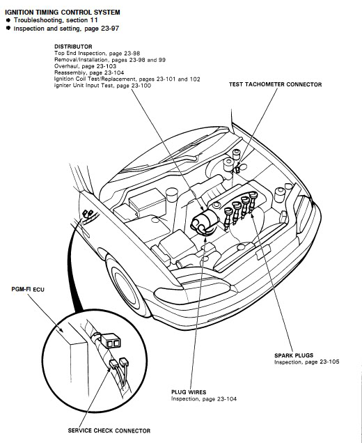

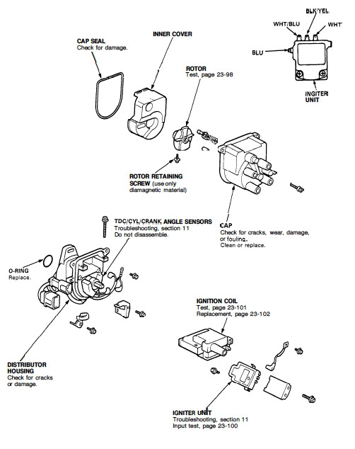

Go to the local auto parts store (or Honda dealer = more $$$$$$) and purchase basic spark plugs (NGK), plug wires, distributor cap, and rotor. Photograph distributor and wires so you know how to hook them back up in the correct firing order.
You'll need a socket wrench to remove spark plugs and distributor cap, and a screwdriver to remove the rotor. You may need to flick the ignition key to ON(III) to position the rotor for removal. Install the plugs and reassemble distributor with wires. Tune up done.
