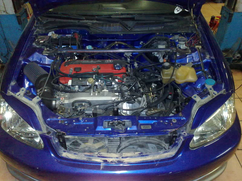

Do you mean something like this, this guy is holding out on what trans he's useing, once i get all the info i think i might try this swap.
But yea, your not the only one thinking about this=)

I wonder how balanced that car would be laterally with the engine now offset, and whether the weight of the driver would be enough to make up for it?

It woulde be no different than a K swap as the K series sits the same way in a EG/EK. That is cool to see done. Where is the radiator and it sucks that the vtec logo is reversed now. I have also wondered this about the F20c and F22c.

anyway, as far as transmission, my bet is either a k20, h22, or f22 transmission. The only reason I included the k20 is how the engine sits to the side... I still think an f22/h22 transmission is probably the best choice though.
And intense, the rad is behind the fans... it's under that cross-member
