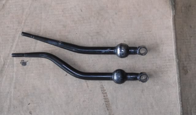

Decided to update my shifter while I had the shift linkages undone to pull the motor in my 95 Civic DX. Looked around and decided to go with double bend shifter from an Integra (I believe 94-01 will work).
Here is a picture showing the side by side difference between the factory Civic shifter on the top and the factory Integra shifter on the bottom:

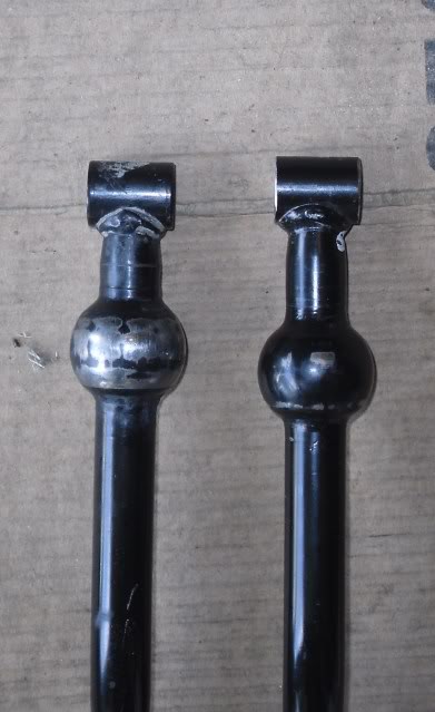

Here is a picture showing the difference on the lower end of the shifters. The end of the Integra shifter is 10mm wider.

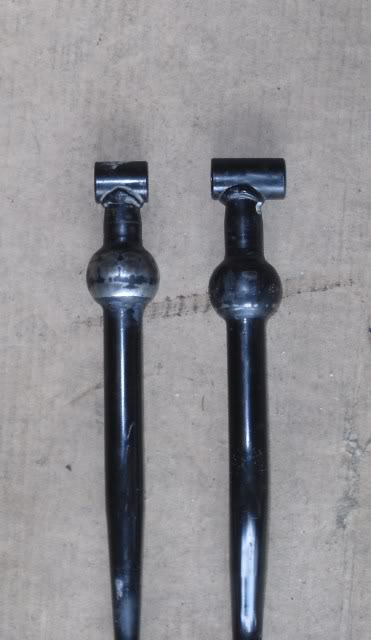

My friend runs a machine shop, so I took it by and he took 8mm off of the long side and 2mm off of the short side to make it exactly the same width as the Civic shifter:

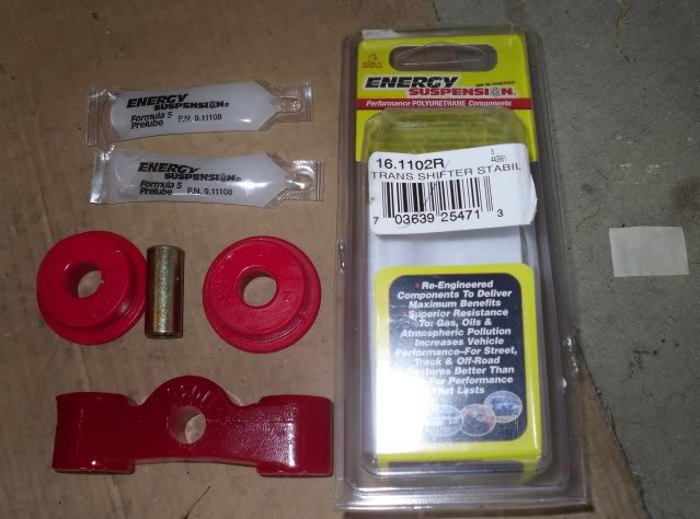

I also got my Energy Suspension bushing kit in:

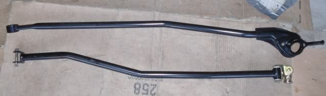

I went ahead and cleaned and degreased the shift linkages while I had them out.
Before:
After:
