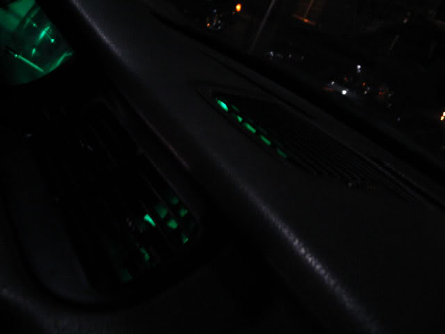

In addition to the bars, I had 4 individual LEDS in the air vents. Running those wires was a pain, and I don't recommend it, but through trial and error mine were a success.

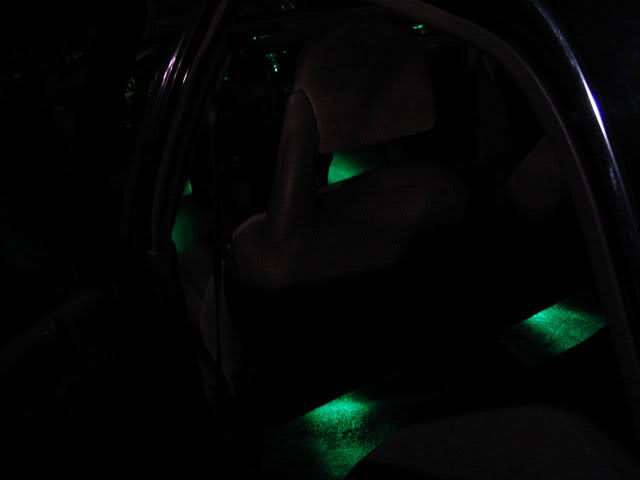

This is how mine looked in my old 5th gen. I used the same setup, pretty much, when I moved to the 6th gen.
Windcalmer's pics show how much better it looks with cathodes.
