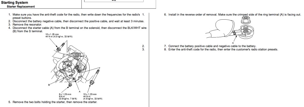

When it comes to the starter thogh i dont have any clue on how to replace that.
Old Mar 21, 2009 | 03:23 PM
If your problem is that the starter does not crank the engine, then focus on the battery and its connectors and then the starter.
If the starter cranks the engine but it won't fire up, then listen for whether the fuel pump primes for 2 seconds when the key is turned to ON(II) and also test whether there is spark at the plugs.
The oil leak is probably coming from a bad seal in the valve cover. It's pretty easy to fix yourself. This will not affect the ability of the car to start.
