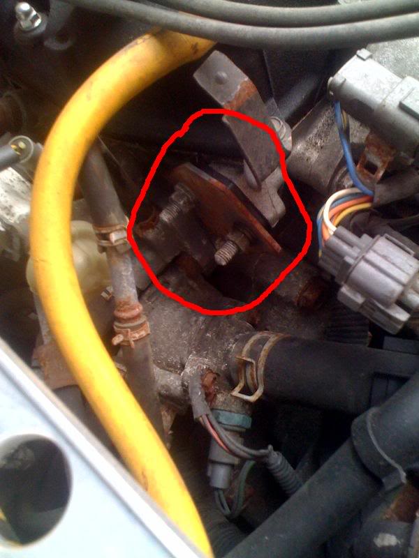

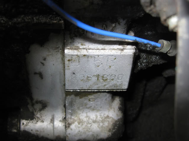

Can any one tell me about this motor like what valve cover gaskets? I say
D15b people automaticly think JDM & vtec

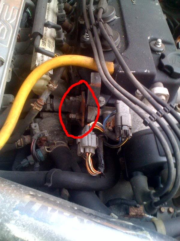

It's a JDM D15B non-VTEC. You probably have this on the back, right?
Oh and I think a D15B7 valve cover gasket will work (92-95 Civic DX/LX)

yes it does have that block off plate.

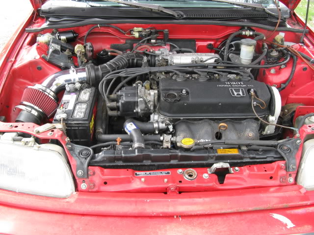

Another quik ? my head is marked PM3-4 is this the original head, the car is a 91 si hatch i believe the original motor was the D16A6 & how does this motor compare?
Old Apr 15, 2010 | 02:22 PM
Wikipedia says the JDM D15B non-VTEC has 130 HP but I highly doubt that info is correct. You'll have to do some searching.

Oh and to give some more details about that JDM D15B... the block off plate is there because the engine was originally Dual Carb'd in Japan. There was a mechanical fuel pump where that block-off plate is. When the engine was swapped into your car they used the MPFI (multi point fuel injection) system that was already there.
And the reason I doubt it has 130 HP is because the OBD1 D15B VTEC has 130 HP... so it sounds like someone made a typo. I think it has more like 102 HP, like the D15B7.
