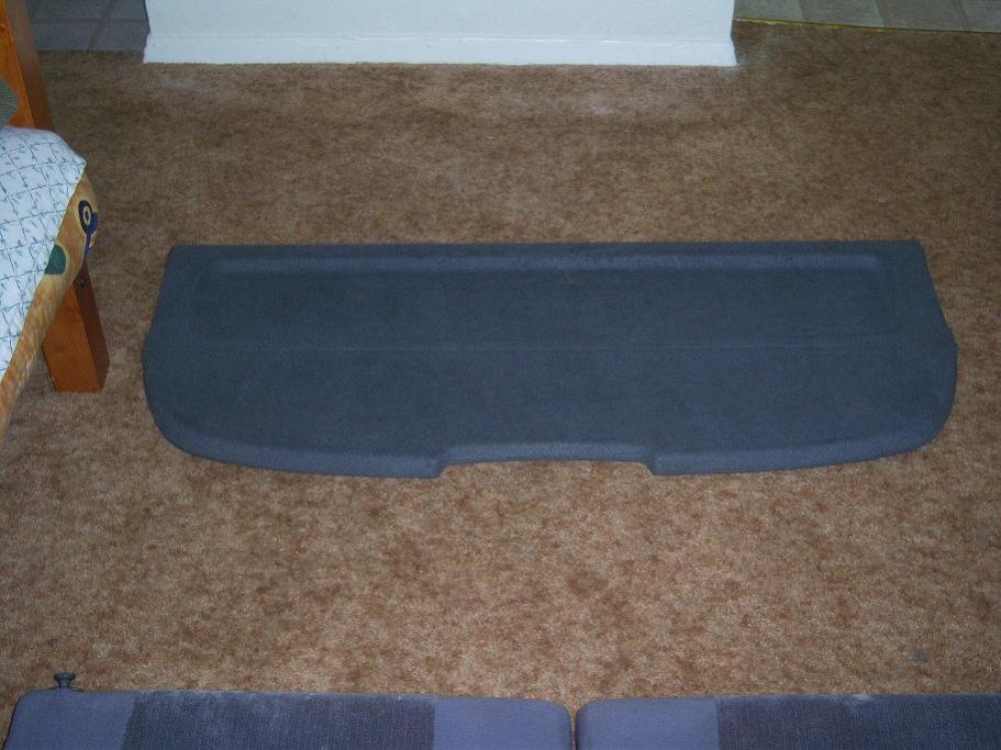

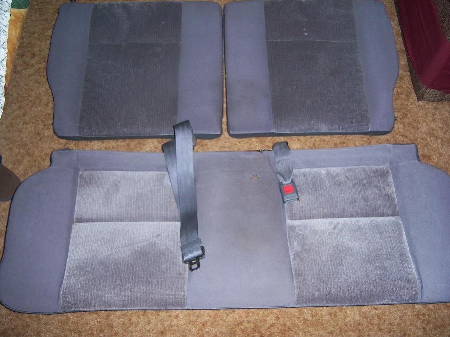

1993 Honda Civic DX, here are pictures. And roll cage?
