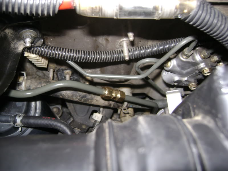

OH MY GOD. I just did a similar thing. I got the lower bolt off but I stripped the threads putting the new one on. I had to cut the old end off to get the stripped bolt off. My fix included a junkyard run and a compression fitting.

Stupid effing bolts...can't take a pic of mine right now cause it's raining (Seattle..who knew?) but enough had to be cut off of the fuel line that the filter is just hanging in the breeze---doesn't seem to bother it though.
Old Sep 7, 2010 | 08:32 AM
It needs to be secured to the firewall. If possible, I would move the bracket and use some self tapping screws to secure it to the metal.
