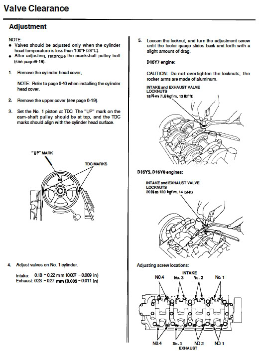

My car is starting to sound like a diesel and know my valves need to be adjusted as they never have been since I put the motor in my car about 15k ago. (D16y8).
Would this be something that I could do (with correct tools)?
Or if I must take it into a shop what would this run?
Any help would be greatly appreciated! Thanks in advance!

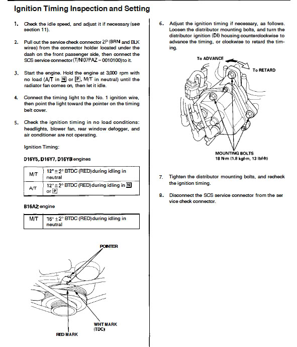

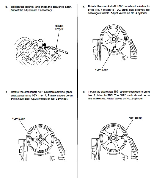

You can do a valve job yourself; however, first check the ignition timing with a timing gun.

Thanks RonJ for the help, you wouldnt happen to have a writeup on how to check the timing would you? I have a timing gun at home but have never used it before and will check timing tonight (I am taking the civic on a 450 mile trip thursday). I want to make sure all kinks are out before the drive.
