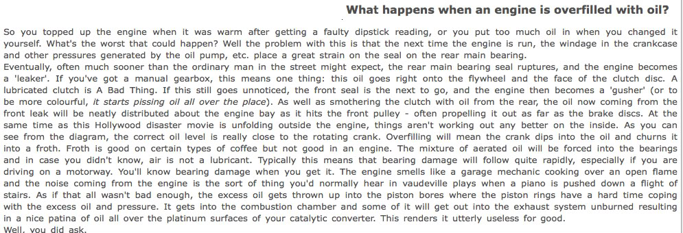

By the way, here's a vivid description for why you don't want to overfill the engine with oil:
Excerpt taken from:
http://www.carbibles.com/engineoil_bible.html
Old Oct 21, 2008 | 09:59 PM
  #38
yea, my car hates me
i'll definitely take care of that tomorrow
