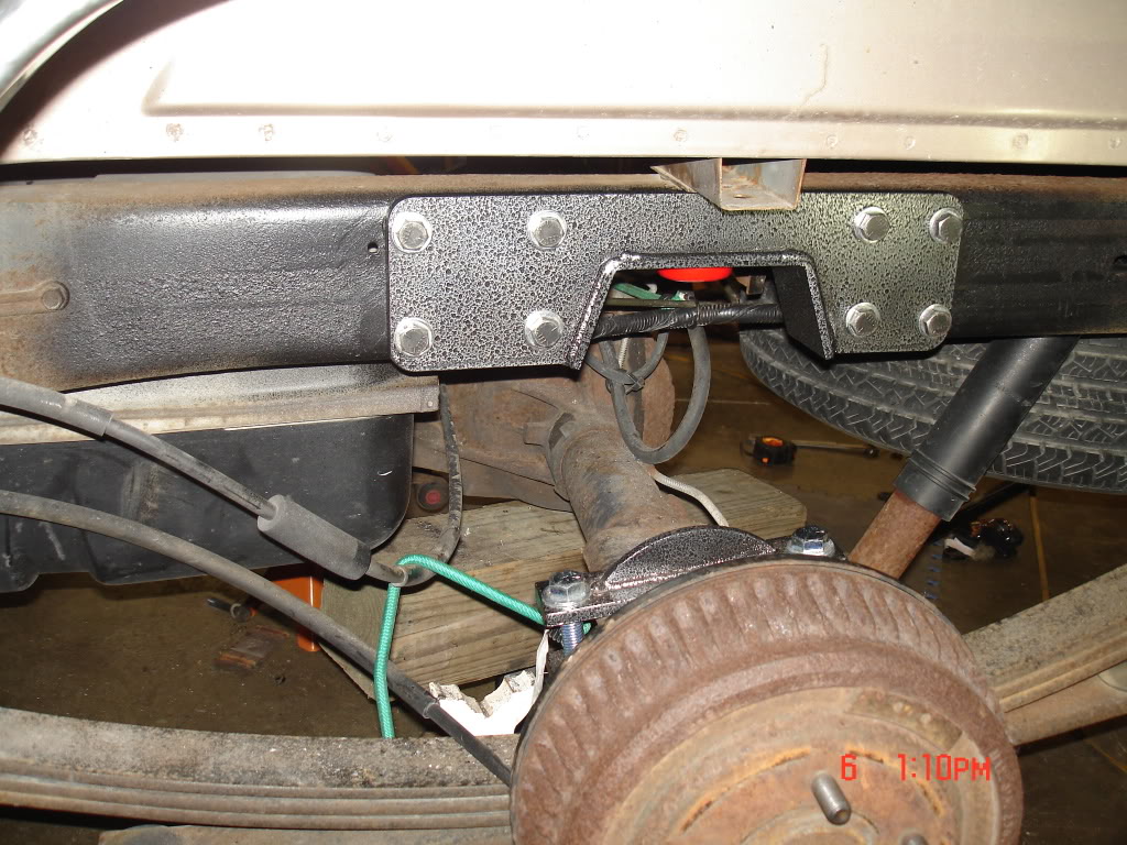

and well i got the one side almost done. had to go out and buy afew new drills my small drill stopped cutting fast enough
i just have to bolt the notch in tomorrow i would have bolted it in tonight BUT after all that crawling under the truck and pushing so hard bent over drilling the frame rail.... well my back hurts so i just sprayed the rail alittle bit and quite. ill feel better tomorrow since im off work ill have all day to do the other rail. and hopefully also do the front as well.
the pieces ive been waiting so long for....
drilling pilot holes and then the final size hole sucks!!!!

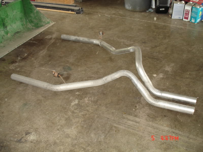

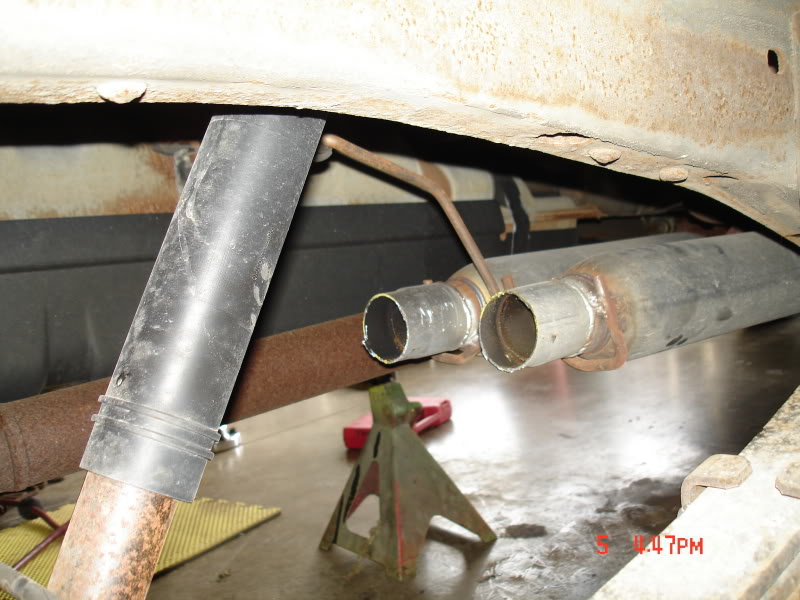

my poor exhaust
this summer eventually ill pull the bed off and clean up the whole frame and paint it with POR15 i know this bed liner paint wont last behind the frame notches. it already has rust coming thru on a few spots on my trailer hitch.

well i got alittle more work today. did i mention that i hate drilling holes.LOL
the trucks got alittle chevy lean tho. i may fix it later this year... gotta see how much the front leans. the chevy lean is due to the gas tank and driver being on the drivers side. so the weight is definatly not distributed very good.
and im pretty sure that i already need to chop up the frame out completely for a weld in step notch... which i have one but its missing the lower plate so id have to make it myself. depends how bad she bottoms out daily how soon i weld it up!!!!!!! but at the soonest this late summer. still need to buy some helper bags if i want to tow anything.
either way late summer the bed will be pulled off and the frame painted with POR15 black. plan on busting out the sand blaster to the whole thing. rust sucks!

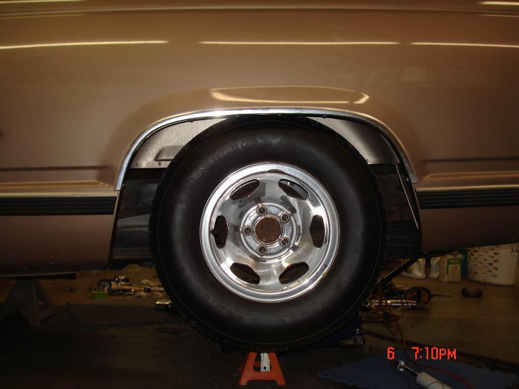

well ok i got it on the ground again and driving, but the front ends still stock i wanted some funny pics and one thing the truck is screaming is I NEED AIR BAGS. LMFAO looks pretty cool, IF only i could flip a switch and make the front go down and back up. LOL
the back does bottom out on a hard dip going fast but not to bad at all.
the drivers side is one inch lower than the passenger.... dam full tank of gas.LOL

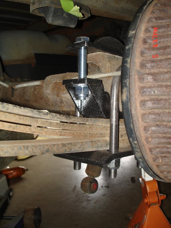

and no i havent got the shock steel sleeve yet BUT i couldnt resist busting the truck out and going for a drive! ill simply take the bolt out and slide the sleeve in when i get it in the mail.
i had to retorque the rear axle bolts already twice and still have to keep checking the Ubolts just to make sure they dont loosen up or stretch anymore.
just have to keep checking to be sure for alittle while. better safe than sorry.

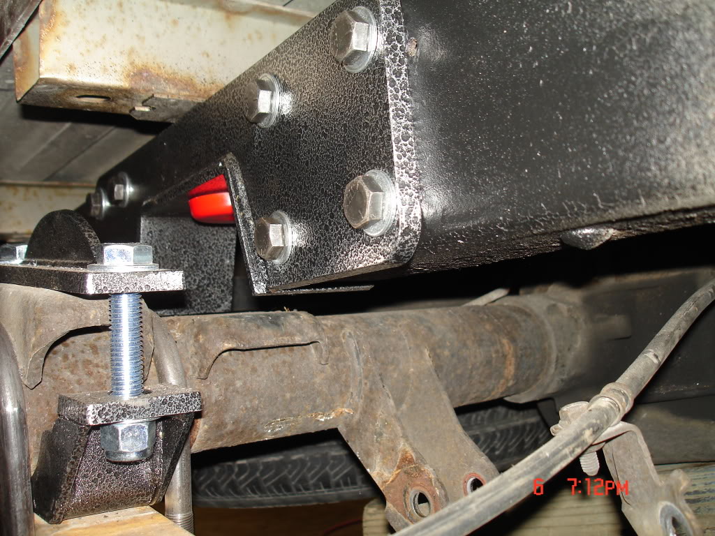

sectioned the bed bracing for the rear pumpkin to clear.
a whopping 7inches of clearance on the rear.... should raise alittle when i drop the front of course.
i drop the front tomorrow after work since i have all weekend off to get the front done and it shouldnt take me but a few hours to get the front done since its simple springs and spindles.

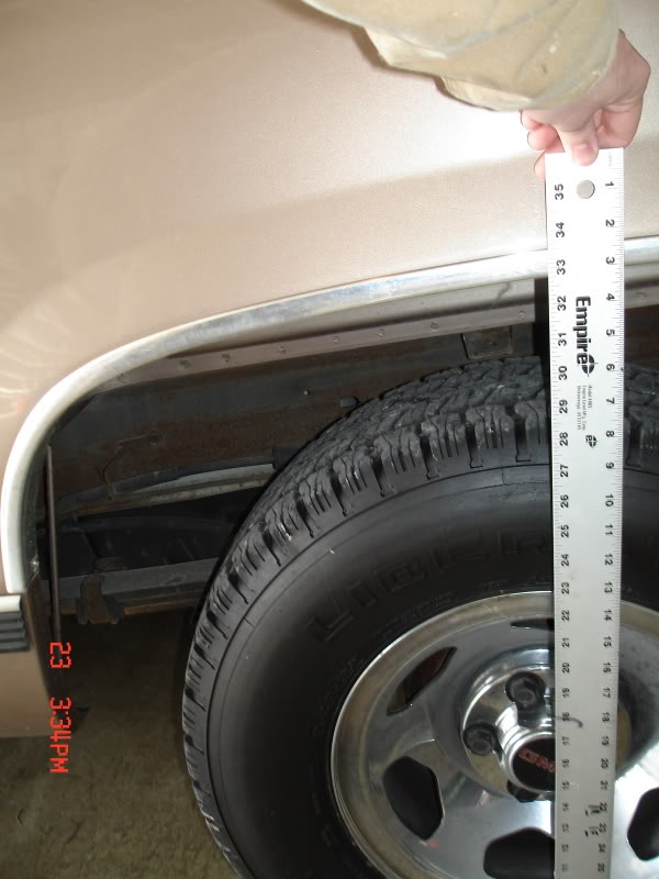

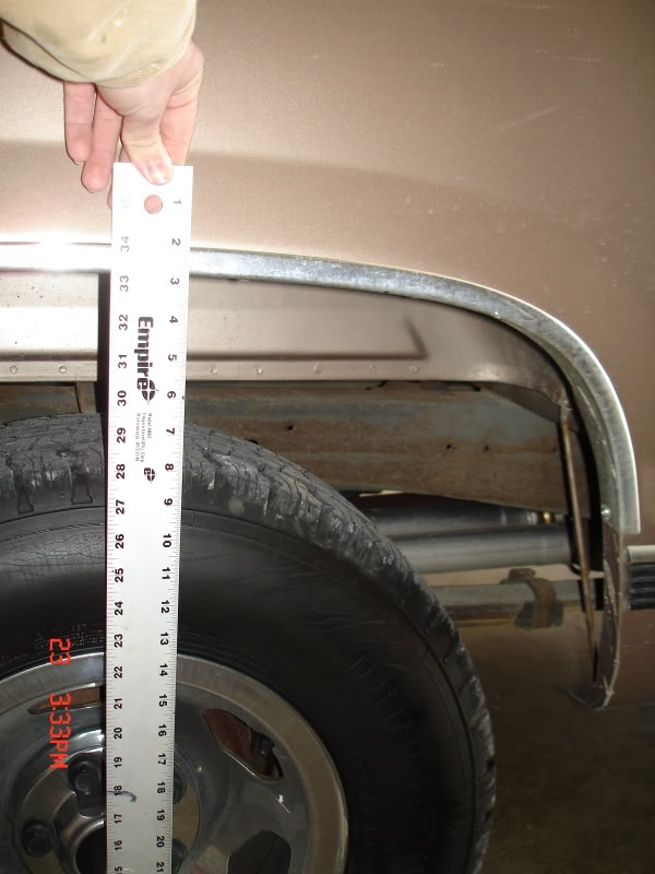

REAR compares
before
passenger 33 1/2
drivers 32 3/4inches
after
passenger 27inches
drivers 26 3/4inches
so ruffly 6.5inch drop on passenger side and 6inch drop on drivers side. my measuring might be off alittle bit
but so far it rides good. needs the front dropped and alignment done. might not be able to get the alignment till the 15th tho.... have to run some numbers and see if i can before then or not..... the cable bill is taking alot of my cash and i also forgot mother day funds. which no way in hell i could skip that. about 100bucks spent there but well worth it to make my mom happy of course. i got the text when she got them "WOW you shouldnt have but im so glad you did i totally love it." she 1K miles away but i can picture her smile. sure it sounds saby but i love my mom. and if i missed it my mom and dad would not let me forget about it.LOL im sure my stupid brother probably wont get her anything.

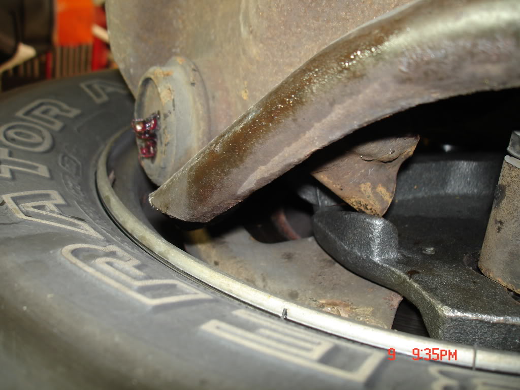

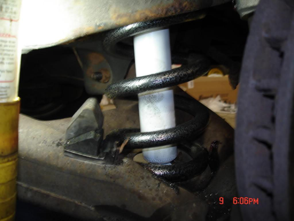

well i got one side done at least... i didnt have to grind down the LCA any for it to clear my wheels but it is close... i might grind it down about 1/4inch on the front just be to safe.
defiantly learned how not to change the springs! the book tells you one way which is NO GOOD!!!!!!! alot easier to just pull the balljoints and spindle and pull the spring out the side instead of pulling the rear LCA mounts. lining up those 2 rear LCA bolts is a huge PITA!

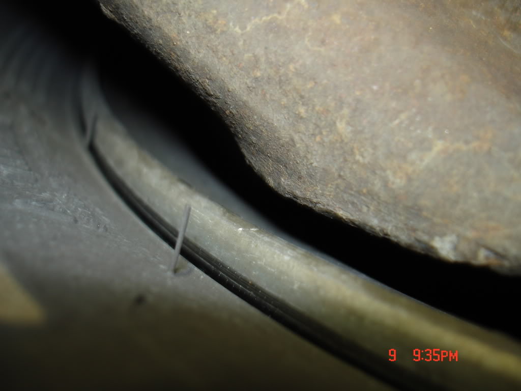

the front lip is very close!!!!

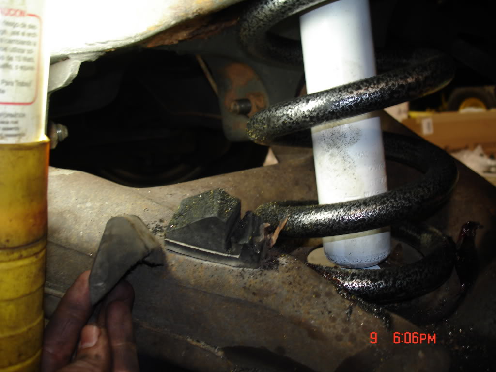

chopped down the factory bump stop.
and the one thing that defiantly bugs me about lowering the front is the instructions say NOTHING about having to bend the hard brake line. that was a bad suprise. defiantly nerve racking bending that dang line!
it hits the top balljoint mount on the drop spindle.
drivers side still needs done of course. and im not sure IF or HOW MUCH the springs will settle. ill do the drivers side tomorrow and then try to set the camber a little better.... i have it set outwards a little to much on the passenger side. since i wasnt sure how much adjustment i had stock, turns out quite a bit
