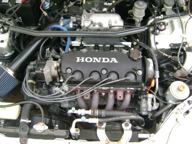

here is the VC i painted wrinkle black ---> https://www.hondacivicforum.com/foru...=74473&page=12
I dont think they have it in high-temp but you dont need it to be. Also after you wet sand the whole VC and SC, take regular sand paper with low grit and start sanding the lettering down before you paint it, once it looks nice and shinny then prime and paint it. It sounds weird to do it first but trust me polishing the lettering when the whole thing is painted is hard because you have to try and not scratch the rest of the VC. It also just makes it a lost easier because you dont have to sand as much and as hard.

I also painted my valve cover wrinkle black (with polished lettering)...it turned out a lot better than I thought it would. I'll have some pics posted up tonight of the VC. Now, I just have to figure out what I want to do regarding the valve cover grommets. They look like trash compared to the VC now. lol. I'll prolly end up painting the grommets and then polishing the bolts. If I have extra time and paint, I'll probably end up painting my strut bar, TB, and intake piping the same wrinkle black.

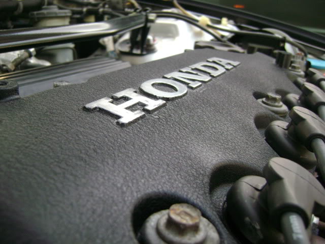

Well, as promised....
I did the VC paint extremely quick since I was pressed for time. Still, I was able to sand it all, polish the lettering/chap stick it, paint everything, wipe off most of the paint on the lettering and take a blow dryer to it to dry it in time. I am extremely happy with the way it turned out, although I still need to touch up a couple places and clean up the Honda lettering a little more.
