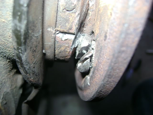

Well, I tried, but I cannot figure out how to get the old stud out. Removed the brakes, moved the broken stud to the "proper" position, smacked it with a hammer a few times, awesome, right? Not really, the stud is now wedged against the hub and I cannot remove it. I would try and thread it back through, but I cut the threads off hoping it would help the situation.
Yes, the back of the stud is hacked up. I have been trying everything I can think of to push the stud back in, or cut the head off. Right now, the back of the stud is against the hub, preventing any movement. Any ideas? If I can create some sort of clearance, that is all I need for right at this second. Here's a pic of what is looks like.

Sawzall the headoff and hammer it the rest of the way through. Otherwise use like a cutting wheel on like a dremel if you can get back there.
