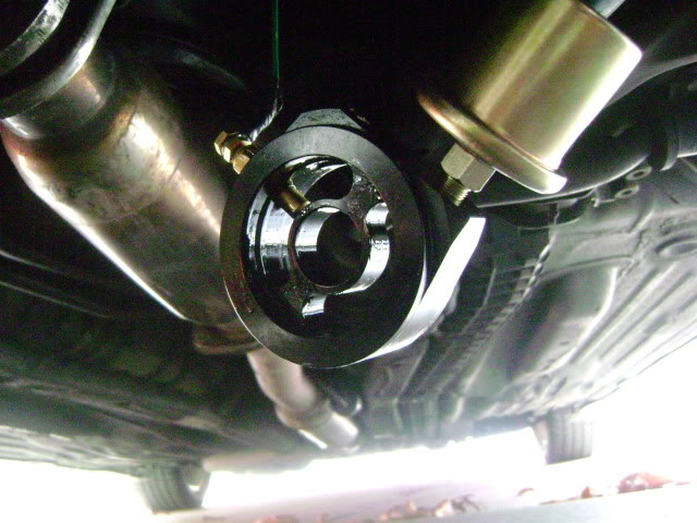

This weekend I plan on getting an oil change done on the g/f's car, oil change on my car, installing PSI sender thing-a-ma-jig on the Mishimoto sandwich, wiring up the oil temp and psi gauges 100%, working on the EGT gauge stuff(*), and other misc errands which dont have anything to do with the car.

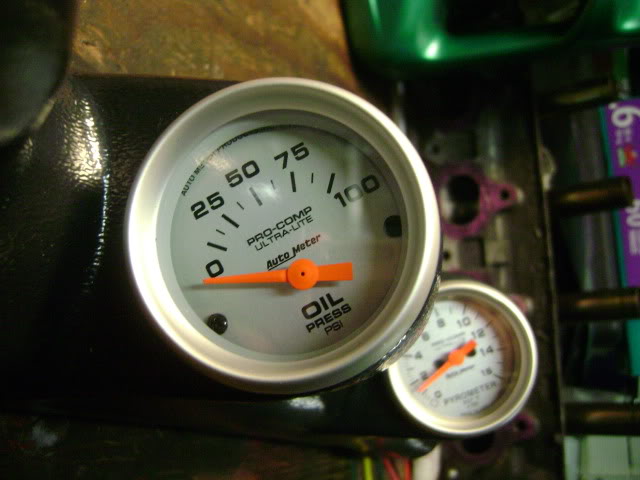

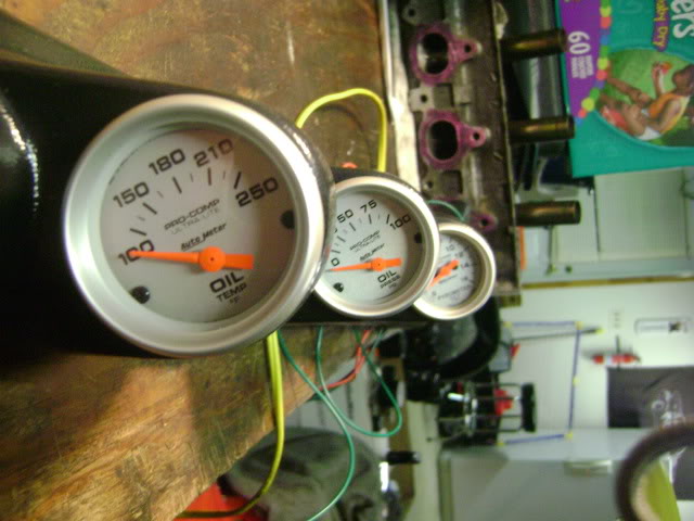

Pics of the Autometer gauges:

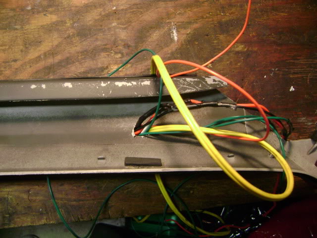

Wiring:
Sandwich plate with senders installed.
Gauges have been in the car for the past 1.5 weeks and are working flawlessly, well except for the EGT gauge still, no sensor set-up done yet. I tried the o2 bung block off idea, but I kept breaking drill bits and one bit broke at the tip and was wedged in. Oh well, it was a good idea at least. haha
