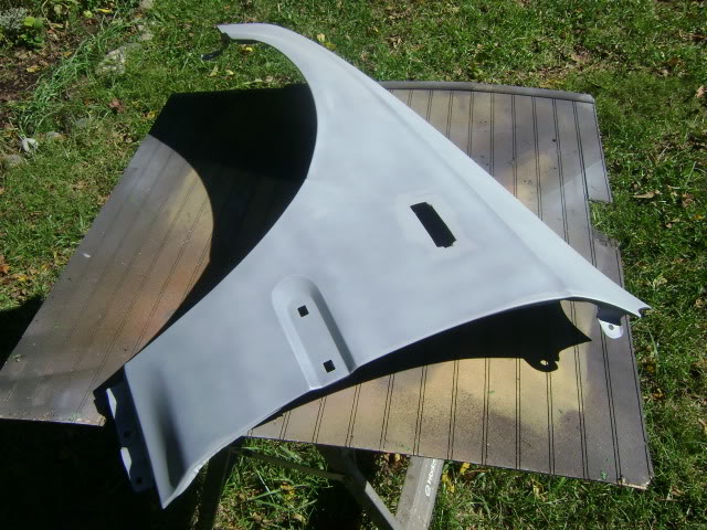

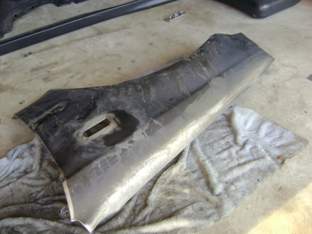

Fender sanded down (surface rust was attacking this fender for some reason)
Primed:
Yes, it was re-painted black. LOL

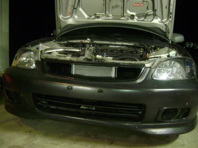

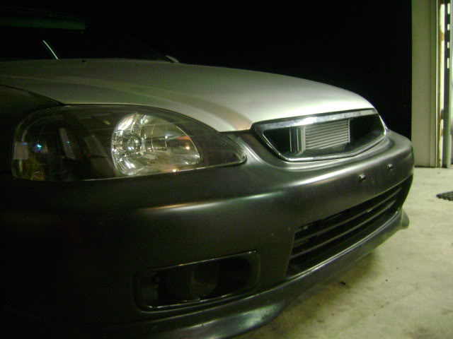

When I had the oil cooler installed, this is where it was. I kind of like it there, so hopefully we can get the thermostatic sandwich plate fixed up and working properly!
A random shot. Well, I actually took a picture of something I was working on here, but forgot what it was actually. haha
