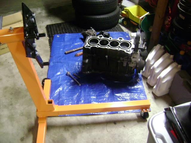

The block has still yet to be touched. I have been pretty busy this week.

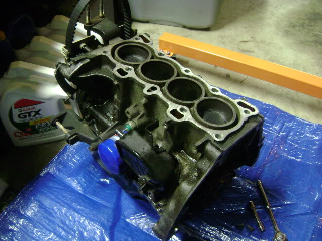

That blue looking sensor.... do you guys think that is some sort of aftermarket knock sensor? I can't think of it being anything else. I asked the guy who I bought it from and he didn't know, he said he just left it there and never had a problem.

harbor freight engine stand ftw

I must have the higher capacity stand... because my Harbor Freight stand is an I not a 3 wheeler. And the knock sensor is blue, I am pretty sure mine is.
Hell yea! 20% off coupon, too. Got that summbitch for $43.
Yea, I think your stand was the next step up. What I am trying to say by bringing notice to it is that the Z6 block should not have a knock sensor, correct? It doesn't matter regardless, as I know the P28 ECU I am using does not have knock sensor control or whatever it is.

I'm almost certain that that blue/green plug in that picture is the oil pressure sensor.

The sensor directly above the oil filter is the oil pressure sending unit. It sends the signal to the cluster which turns on/off the oil pressure 'dummy' light.

O jeez. Do I feel like an idiot then

Yeah man thats the oil sending unit. I just tapped into it 2 days ago. lol
i was looking for a blue plug...(in my eyes that plug looks green lol)
