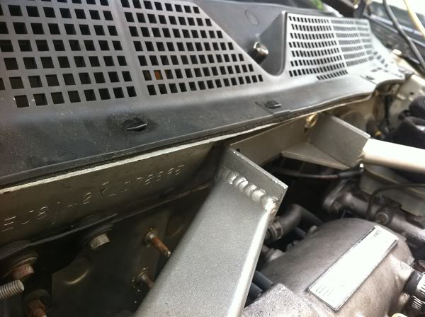

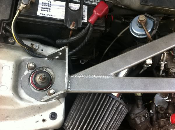

Originally Posted by Shandles
is that the three point strut bar installed? how'ed you get it to fit? take some pictures of that 'sum bitch!
Yes,yes. The 3pt strut bar is in the pic I'll get something posted up tonight for you Shandles. Fitment is tight around the strut bolts, and the passenger bolt hole that should be on the firewall is about 3/4" off the firewall, so it is installed with 5/6 bolts/nuts holding it down.

Hey ya' go Shandles!
Don't mind the paint missing and the zip tie, I spilled brake fluid on it a while ago and the tie is holding the hose from rubbing my freshly painted VC.

aw heck yeah! thats what I'm talking about! Thanks man. You were right too, the material does look a bit thin and flimsy. Does it seem sturdy at all?
Got my tax refund finally... time to buy a few things for my project!
Old May 5, 2012 | 05:01 PM
  #1086
Metal doesn't seem thin, just "soft", the nuts that go onto the top of the strut left imprints in the bar.

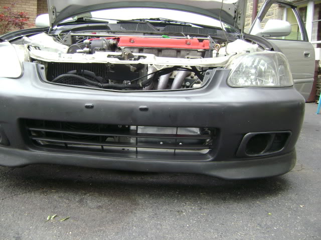

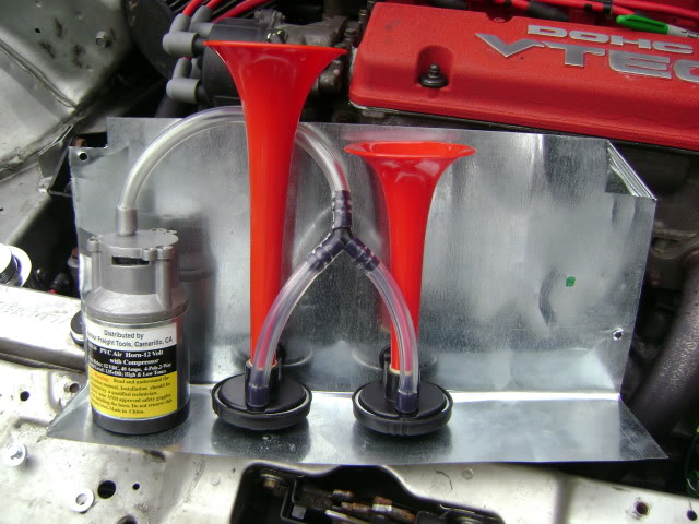

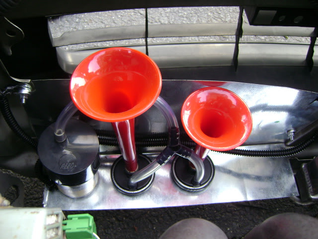

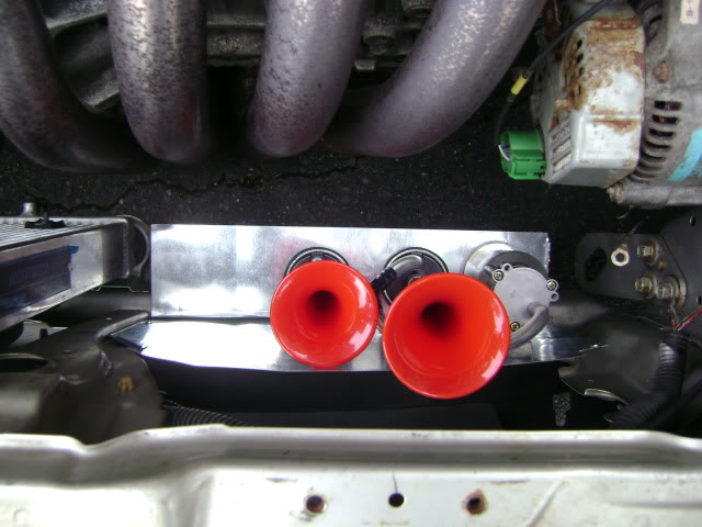

Spent a few hours on the car this afternoon and got the horns installed and working 100%. Here is what I made to go in place of the A/C condenser.

Now sitting in the A/C condenser spot.

Behind the bumper.

All wired up and ready to go.
I took a video of the OEM horn and the new horns. I will make up a youtube video sooner or later. The horns were $10 from harbor Freight.

^^Yea man, I love the sound of the horns. Just wish I went with train horns so they could be even louder! No thanks on the big compressors and all that nonsense though.
I plan on relocating my coolant over flow to the left over spot next to the radiator. Also, I will mount another piece of metal so the piece I made extends all the way up to the upper radiator support. It should help direct air flow into the radiator instead of around it . I will probably end up paint the entire thing black so it is all hidden too.
