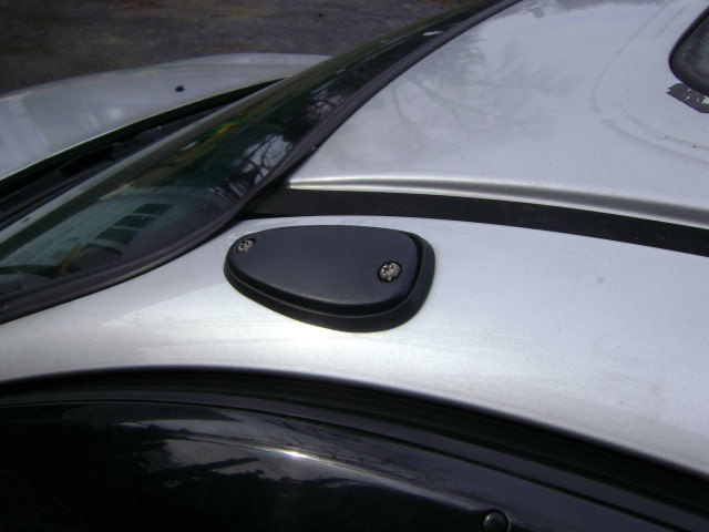

OE Antenna block off

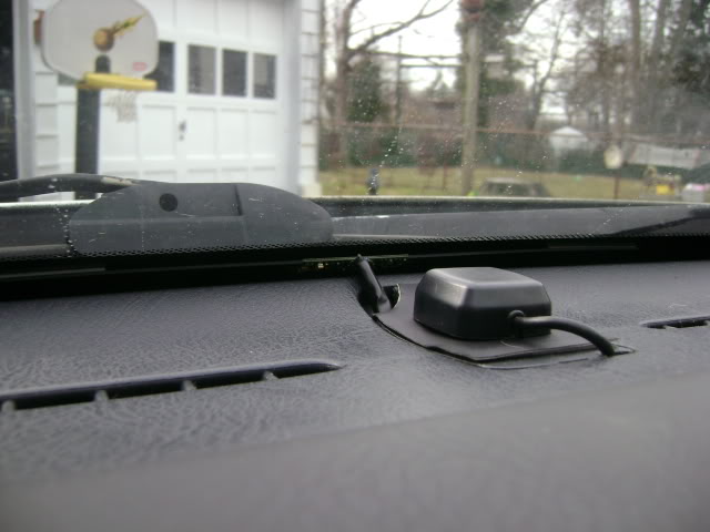

Internal Antenna

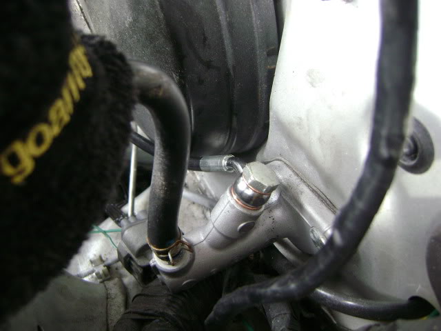

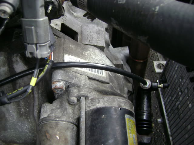

Rywire stainless clutch line

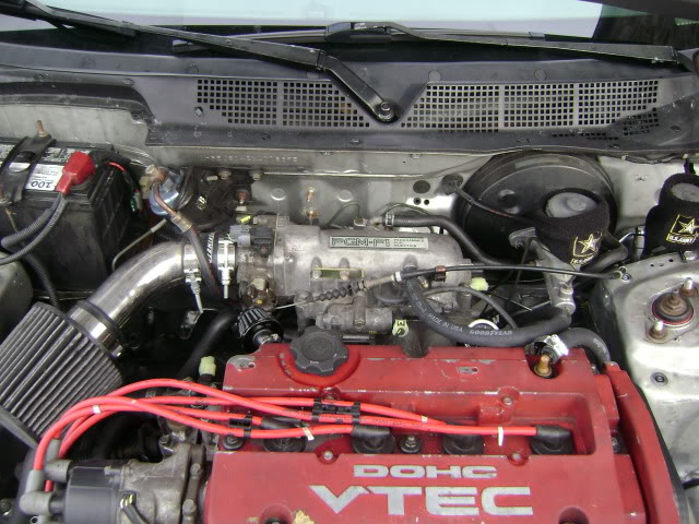

Updated engine bay shot

Clutch line looks nice, looks like its like a rubber line type of deal still? Mines switched over to stainless braided, cost me like $60 I think. Need to paint that valve cover, and should've painted the engine while it was out, but bays coming real good. What was your skunk2 manifold hitting on when you had it. Brakes lines? Or firewall? I would've just hammered **** out of the way lol. At least the h22 manifolds are super easy to port since they are 2 piece, don't have to cut and weld.
Old Feb 20, 2012 | 11:09 AM
  #985
Clutch line is a stainless steel line with a rubber sheath or whatever you call it over it. If I can get a good enough picture, up close you can see the stainless braiding underneath the rubber. I spent about $65 for mine.
