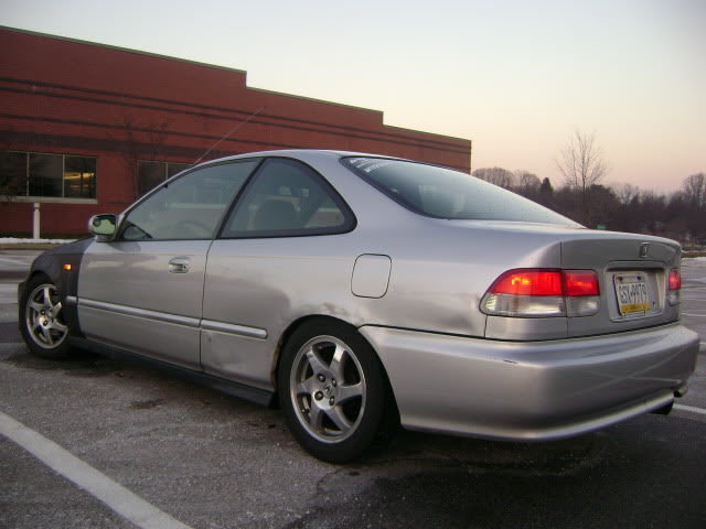

I am not going to vinyl wrap it. I already know it will look like **** due to the body damage in the back. And you are right, it would be about $1k-$1200 for a good install. Plus, my luck would be that a shopping cart or something hits it, tearing the vinyl or F-ing it up some how.
You can see by the reflections on the car that the metal before the wheel well is all "wavy-like". Ugh.. I hate looking at it. These pics were taken 12/2010. Trust me, it doesn't look any better now than it did years ago. :/
As for the plastic dip, I am going to buy a can of it and play around with painting my grill I think. It is a cheap $20 eBay part so I am not worried if I mess it up. Also, I should be able to just peel it off if I don't like it and if I did it right.
If that doesn't work, looks like I am sanding the bitch down and spray bombing it a flat gunmetal, or black this summer. Even though I REALLY do not want to do that.

I have similar dents right above the wheel well, but not the ones on the sides of it >_> i brake checked some ******* last xmas and he rammed the side of my car like %$%ing roman chariot style haha, and since i have liability insurance and no spare time i wasnt able to go to court to make him pay...
anyway for the vinyl wrap cost you pretty much could have gotten damage repaired and painted, and then a shopping cart would still hit it!

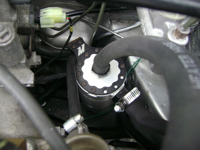

Catch Can - Just thrown in for testing. I need to find a permanent spot in the bay for it.

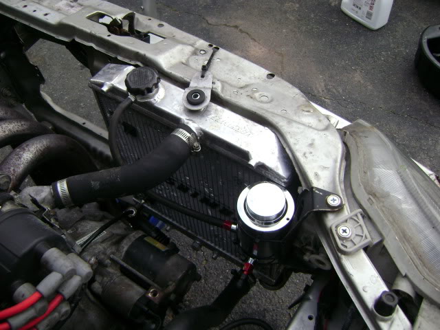

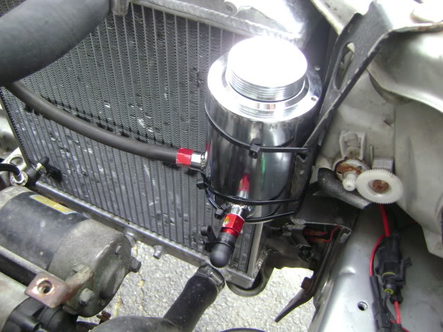

Over flow - Here's the story, I wasn't paying attention last week when I was working on the car and moved the overflow off to the side for room where I was working. Ended up placing it on the exhaust manifold. In a rush to leave and pick up my son, i forgot to move it. Arrived 14 miles down the road smelling like burnt plastic I pop my hood and realized my mistake. This is a Mishimoto power steering reservoir, I just blocked one of the opening until I can confirm the thread pitch and buy a bolt. The top has holes for mounting, but I am leaving them as is since the holes can act as a vent. I plan on making a steel bracket and relocating it on the bottom of the rad support where the A/C used to be.

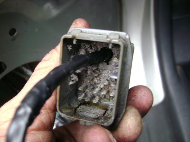

Power fold wiring - Found a spot on the connector where 4 spots were not used by wires. Instead of getting my hands messy by actually pinning the connector etc, I drilled a hole through both sides and ran the wires through.
The passenger side wires should be in the cabin this weekend. Hopefully, I can get this install 100% done soon!

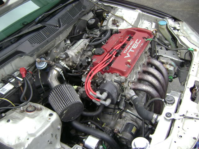

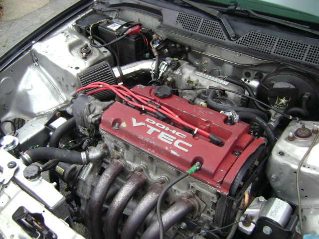

Updated Engine Bay shots:
