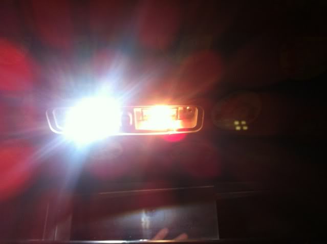

I got lazy last night. I took pics, but didn't feel like uploading.

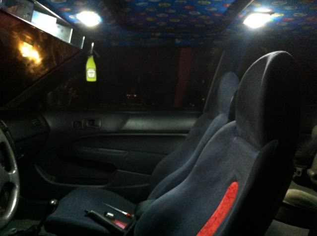

Interior: Obvious on which is the old OEM bulb.

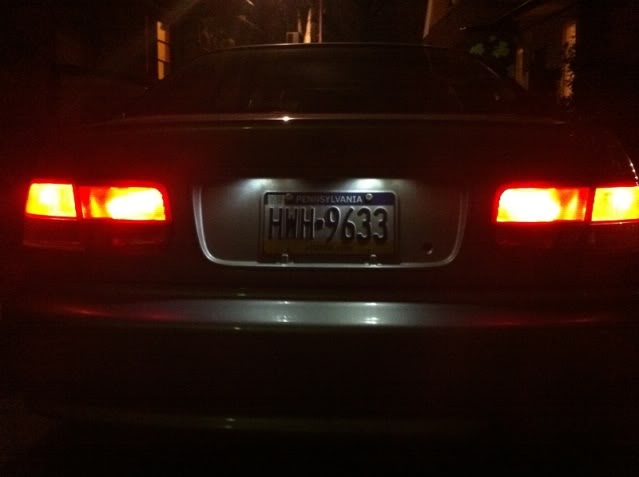

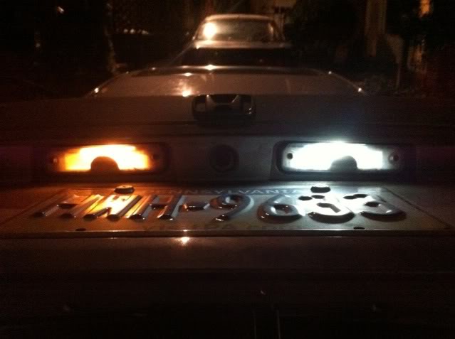

License plate:

I am very happy with them! The trunk light flickered a few times, and then stopped working. I put that LED in the dome light and it did in fact work. There must be something a little screwy with the trunk dome light wiring or the base that accepts the bulb? I'll play with it some more this weekend. Not overly concerned with it to be honest.
Old Mar 16, 2012 | 06:34 AM
  #1028
Squeeze the terminals closer on the trunk light. I had the same problem.

What are all the part numbers for the bulbs? I want to do the same, no rear interior means opening my trunk lights up the whole car since the light will go past what would be seats lol.
Old Mar 16, 2012 | 11:23 AM
  #1030
Scott, this is exactly what I ordered. Copied from the receipt I had in my E-mail still.
Qty | Product / Options | Price/ea |
4 | 3022-xHP4: 4 High Power LED Festoon Bulb | $ 6.95 |
3022-CWHP4: Cool White
2 | WLED-x4-x: 4 LED T10 Wedge Base Bulb | $ 2.59 |
WLED-W4-90: Cool White Wide
Obviously, the quantity of 4 are the interior/dome lights, and the 2 are the license plate bulbs.
