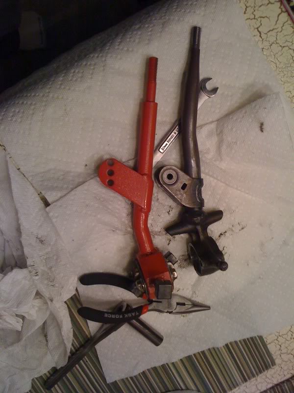

I bought a JTC short shifter. Here is a pic I found:
The one in red is the short shifter, other is OEM. What this does is re-positions the cable to the higher bolt holes, making the throw much shorter. They make one for the 5th gen prelude shifter box, too but it looks a little different. Same concept I believe though.
