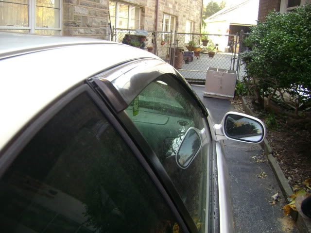

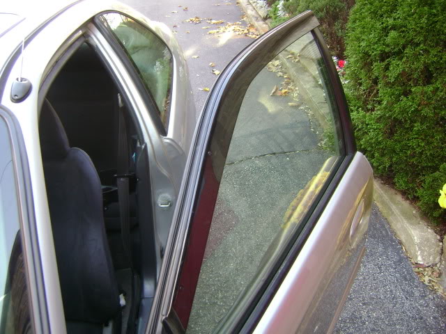

Pics of the visors! Installation is extremely easy. I had them installed and everything put back together within 45 minutes in the dark while it was windy and 30* F outside.
