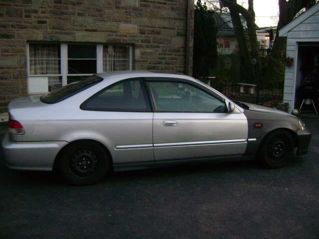

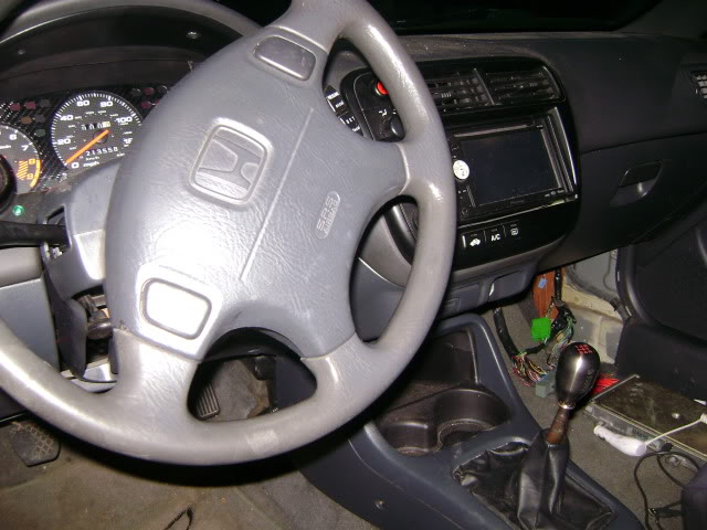

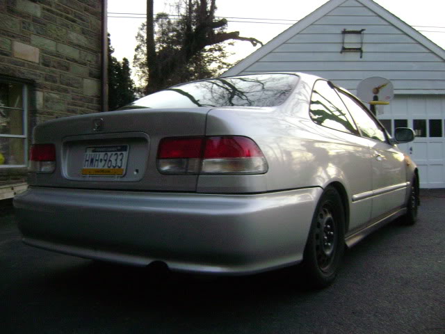

Never heard of a tone generator actually. I'll have to look into it. Ended up re-installing the cup holders today and replacing my fuel pressure regulator in addition to cleaning up my garage 100%. Just some pics I took before the sun went down. I also replaced most all 10mm bolts with some nice shiny screws and finishing washers from home depot. Cost me like $15 total for about 30 of them. Couldn't get a decent pic since my camera sucks.
