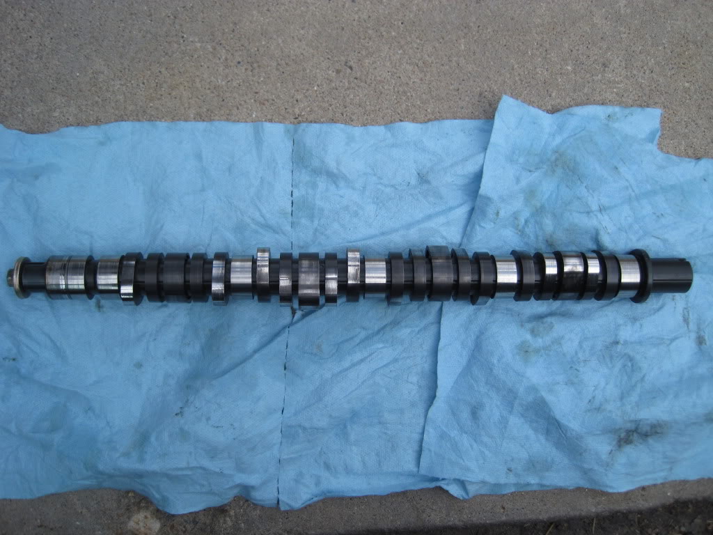

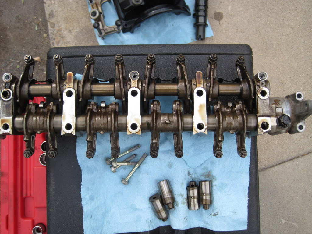

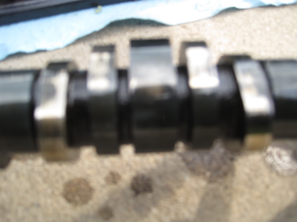

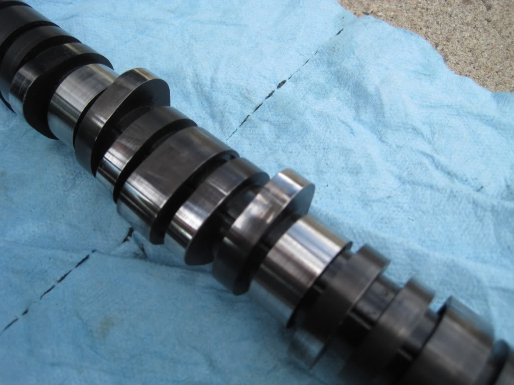

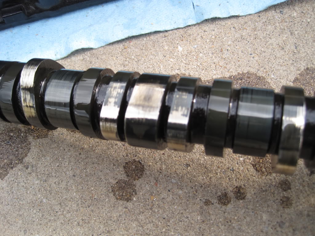

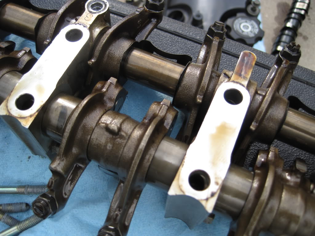

So then after i couldnt get the stock one working i was getting ready to take it out again. So i get my wrench onto the crank, turn it so my cam gears "up" is pointing up and i look down onto the crank pulley. All i can say is WOW i cant believe i forgot to check my timing, the one thing i was so worried about before swapping these cams rofl. So while the cam gear was "up" the notch in the crank pulley was about an inch in front of the mark on the t-belt cover.
I finished timing it at about 10 last night, runs just fine now. So today after work im going to put in the new cam i got (again >.<) and double check my timing, i feel like through my forgetfulness i didnt check it in the first place, so i assumed the cam i bought was ****. but hey hopefully after work today ill get it in right and it'll make a difference...heres some pics
Here is the new cam (supposedly d15b)

233k mileage rocker arm assembly

And here is the stock cam
