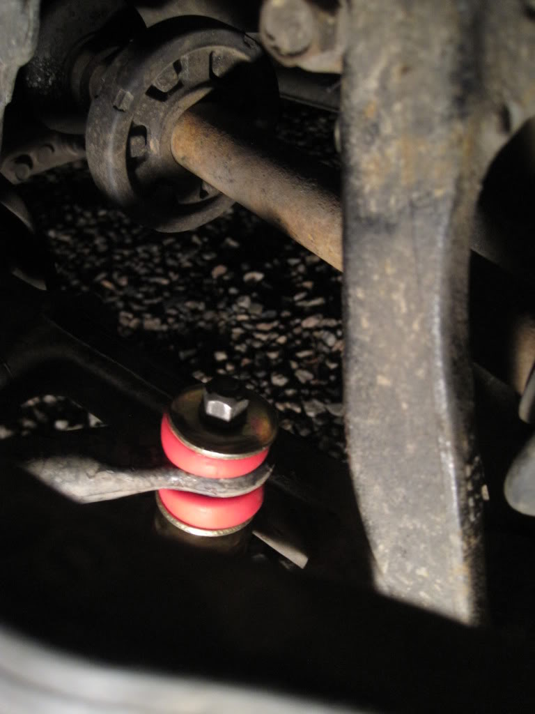

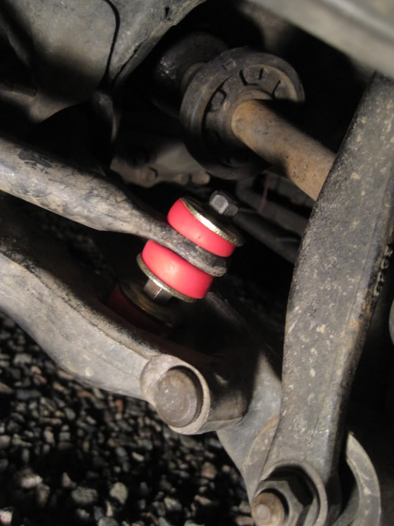

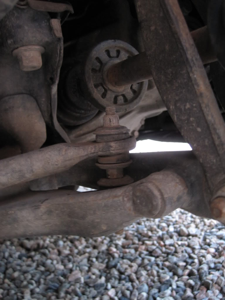

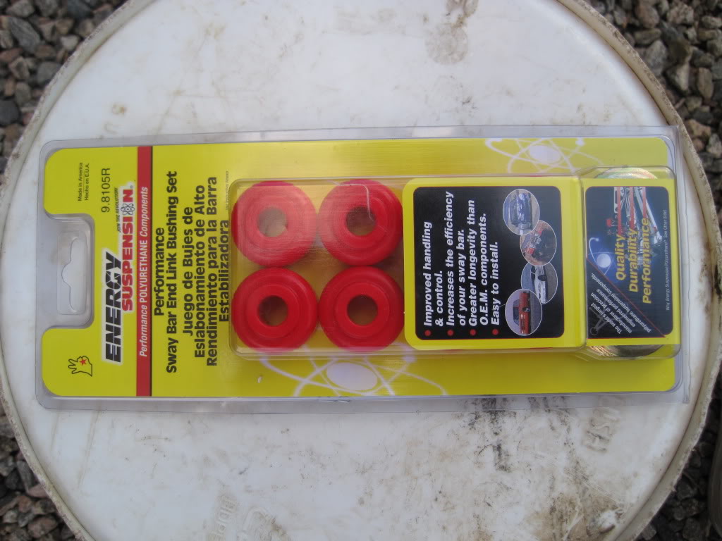

A couple of days ago i picked up some polyurthane energy suspension sway bar link bushings from advanced auto for 10 bucks! They are universal bushings so i did have to do some modifying. The bushings were too thick so to shave them down my buddy held the bushings with channel locks and we sanded them down with a belt sander...surprisingly it worked out very well lol. Anyways this was a quick and easy install but made a HUGE difference. Between the rear sway bar and these bushings my car handles 200% better, i highly recommend these bushings, 10 bucks for them and you can definitely tell a difference.
Old bushings
New bushings

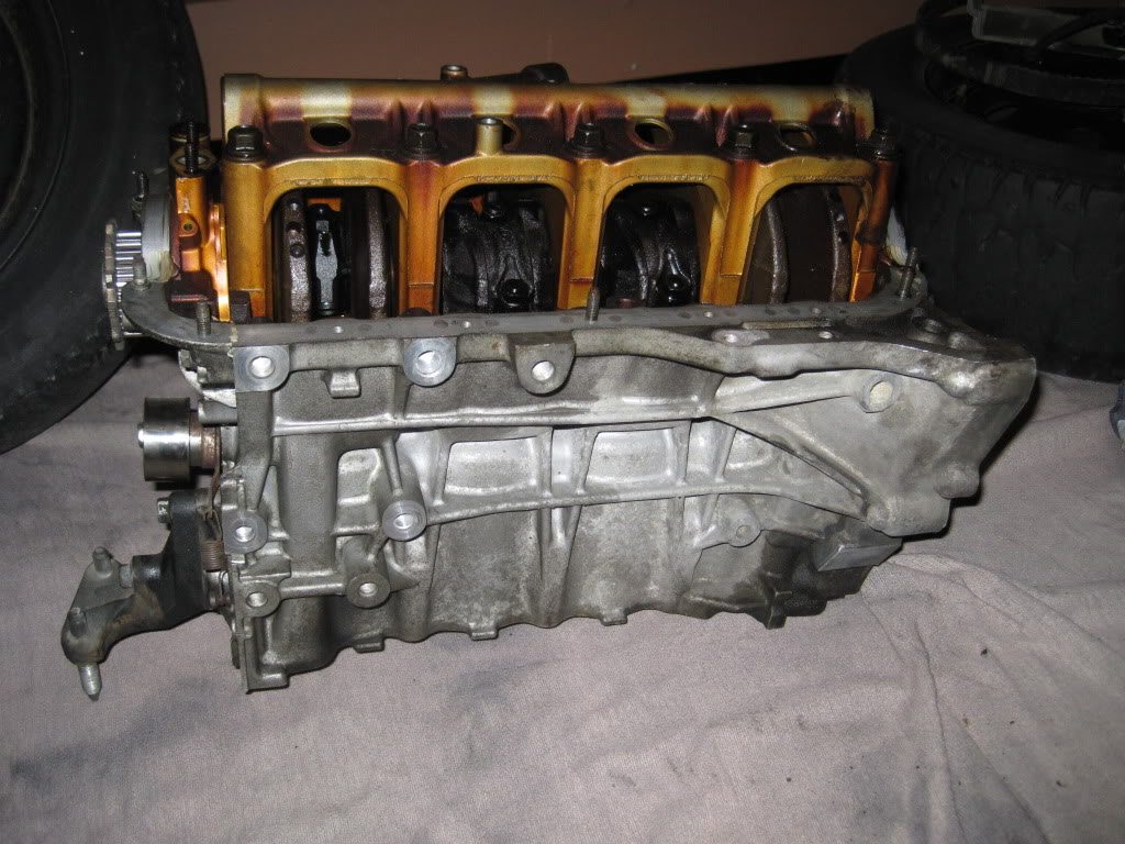

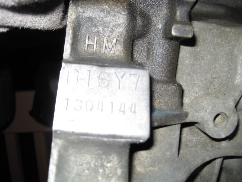

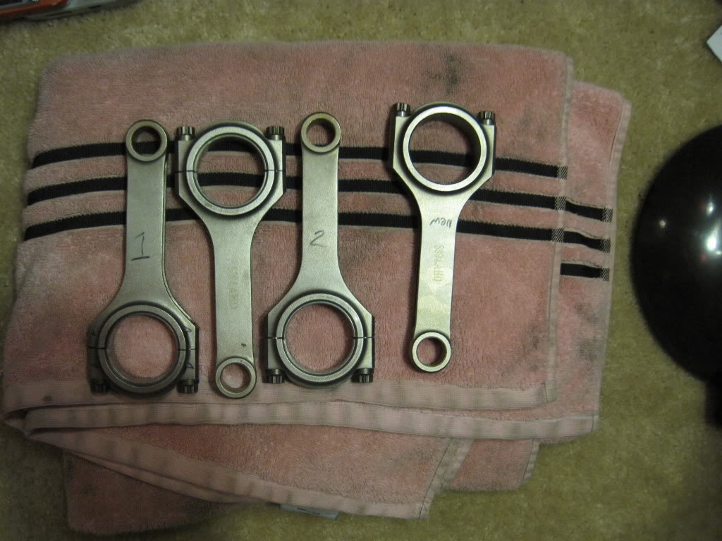

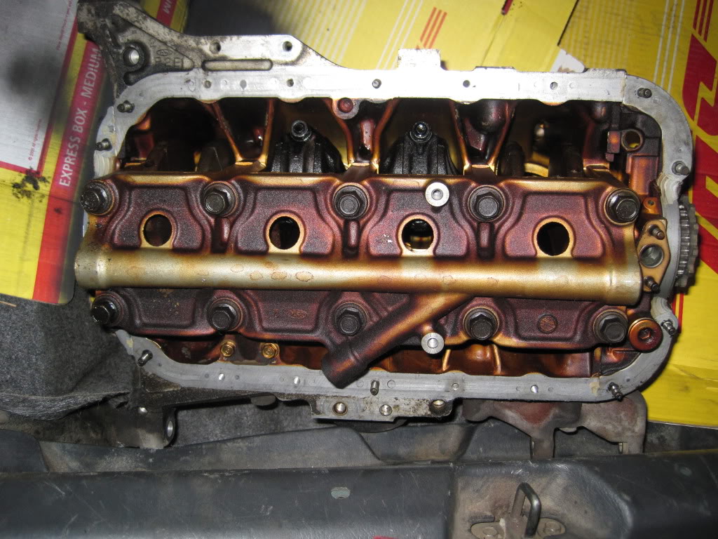

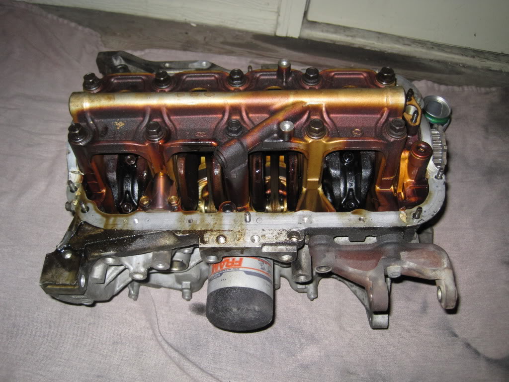

photobucket isnt working for me, so ill have to put pics up tomorrow. But anyways today i picked up some brand new golden eagle forged rods and a d16y7 block for 220$ together.
Now its time to save up for some vitara pistons and acl bearings and ill get this motor all reassembled, then i get to look into turbos =D
