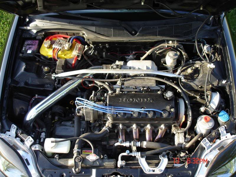

stole hte pic from addiction....but the little grommet and sensor you plug into your intake, does that just hang with the new charge piping?

yea take out the gormet from the origional drill a hole in ur new charge pipe and put it back there if not and u let it hang in ur bay its going to pick up the temp of the air around the engine which is going to throw things off

IAT sensor in my engine bay is just sitting off to the side ziptied to my shock tower. I didn't have anywhere to put it and it hasn't made any kind of difference for me at all really.
The best way to do it is to get a B20 IAT sensor from a CRV and weld a fitting into your charge piping and screw it in with some hondabond or other sealant. If you can do it that way it would work the best.
O2 sensors are easy. Always put 2 bungs in your downpipe, one for the wideband and one for your stock primary O2 sensor. You can completely disable all of the O2 sensors but i'd suggest having the primary O2 still in.
