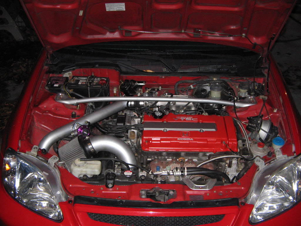

I don't know that turbo, and I never ran any water lines to mine so I'm not going to be much help in that department.
Also, heres an alternative to using the "cai hole." My charging piping didn't allow me to run it through the hole, but honestly, I think this looks cleaner anyway.

and Tony, thanks for the picture. For your vac manifold, did you run your brake booster line right to the vac mani, and then supply your IM with a vac line right off of the vac mani? Is that what i'm seeing? And i agree that that that looks clean (the chrage piping), i think i'll have to figure it out once everything is mounted and i'm actaully running the piping, but thanks for the idea man

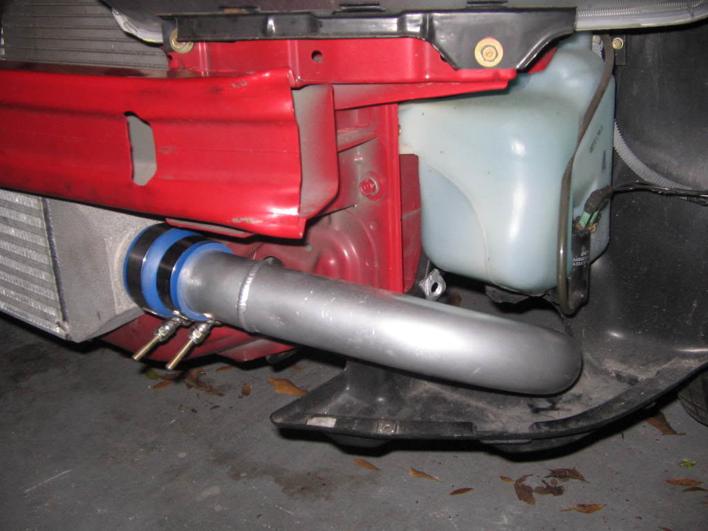

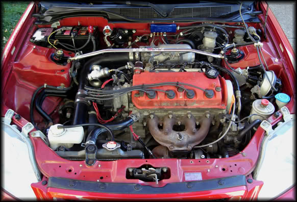

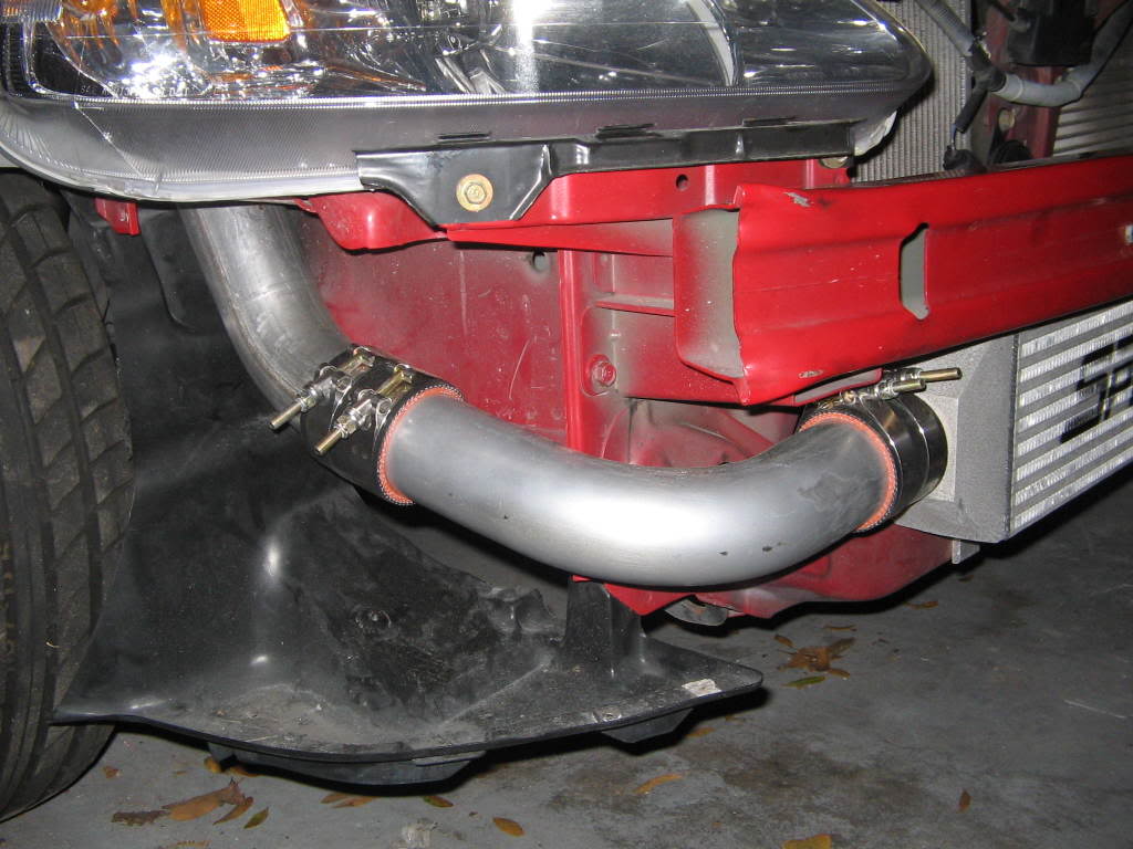

I dont mean to start controversy in the IC piping debate but if you think about air flow (with exhaust or IC piping) you want as few bends and as light of bends as possible to get optimal flow. With forty's piping you are getting alot moretight bends than if you run your IC piping through the hole where the stock airbox was. A good way to tell which is better is to add up the total degrees of all the bends needed between 2 givenpoints.
With my piping I have a 90, 45, 45 and one last 45 to the thottle body, thats a total of 225* of bends. With fortys piping he has a 180, 90, 45 and a 90 to the throttle body, thats a total of 405* of bends. This is just how I make sense of it. You can do it either way if you prefer the look of one over the other.
Pic of how I ran mine.

^ REALLY helpful pics, and i think everyone would agree that the less bends you have the better, thanks alot man
