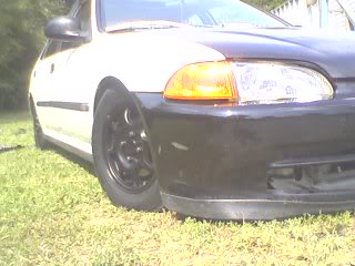

i slammed my 95 sedan and put 155/70/13 so i wouldnt have and rubbing issues
and never had any wear issues
the wider the tire and lower you are the more important the camber is, if you dont want uneven wear,
