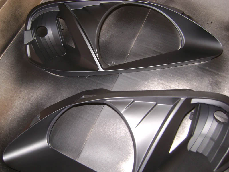

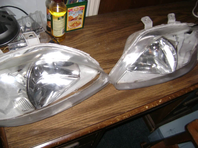

Ok, so I went a little off course from the Si conversion. I didn't want this to be a Civic SiR, but I have spare headlights and matte black paint. It was only a matter of time before the two decided to go spawn some bastard love child. I knew this was a possibility, so I put the matte black paint in a box. Unfortunately it escaped.
I first realized something was amiss when I found this...

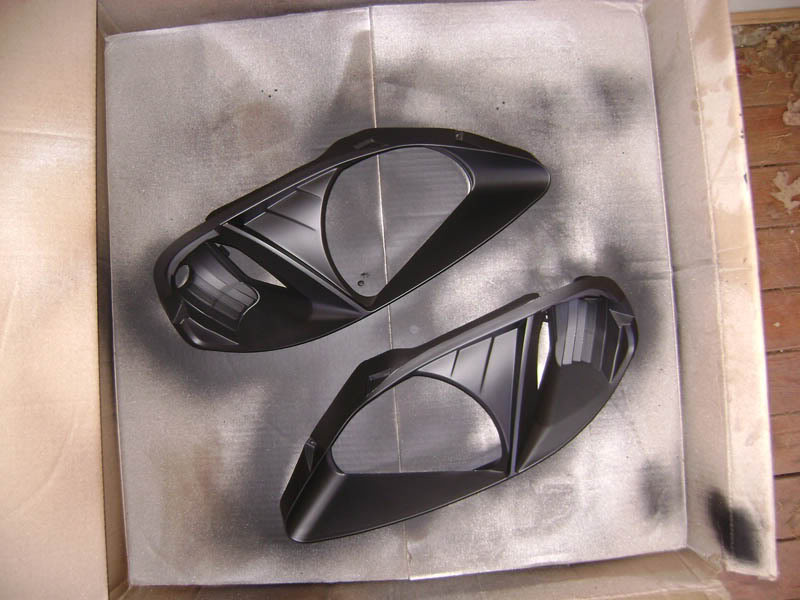

Something wasn't quite right. Then I found THIS.

SIN!

We'll see if they rock or suck. If they suck, I have more paint! You know, it was ridiculously easy to get them apart. I kept reading all the DIYs about how to put them in the oven if you have an oven that is big enough and all that, but all I did was use a hair dryer. I put it on the low blower setting and the high heat setting, stuck it in the hole for the headlight bulb (after removing the rubber seal), and let all the exhaust heat come out of the turn signal bulb hole. After about 5 minutes the lens was hot to the touch so I started prying and pulling and viola! pieces of headlights. The seal goo came right apart. While I was at it, I polished the inside of the headlight lens with Meguiar's PlastX to get rid of the oxidation and they're pretty much mint now. I'll post more later when it's back together and done.

hum... guess i had some screwie headlights. mine where a pita to pull apart!
looks good so far.

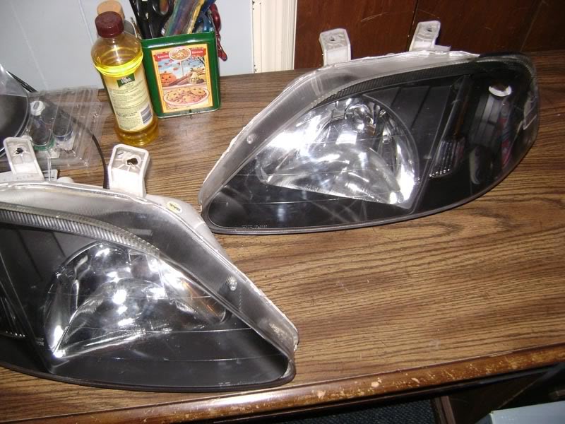

Well, here's how they turned out. They look like every other CTR and black housing headlight I've ever seen. Man, resealing them was a pain! Pics of them on the car a bit later.

That looks pretty sweet! how did you reseal them?

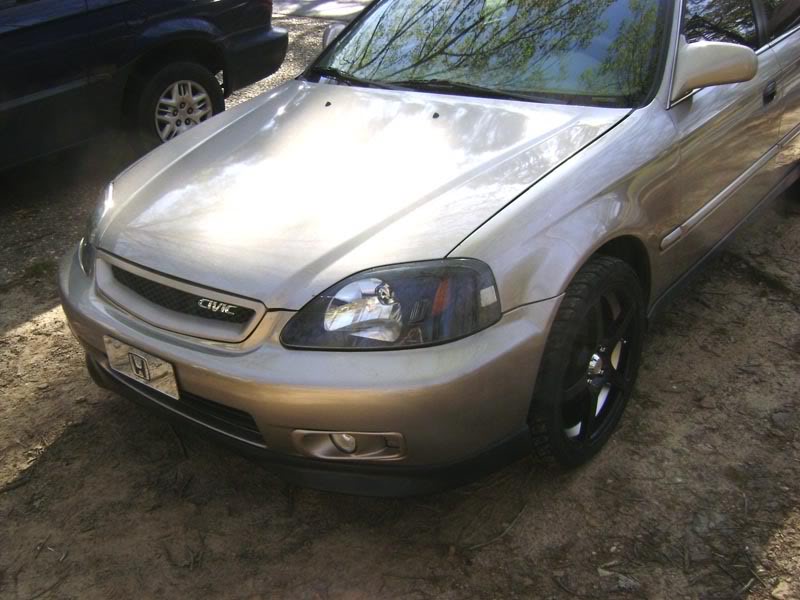

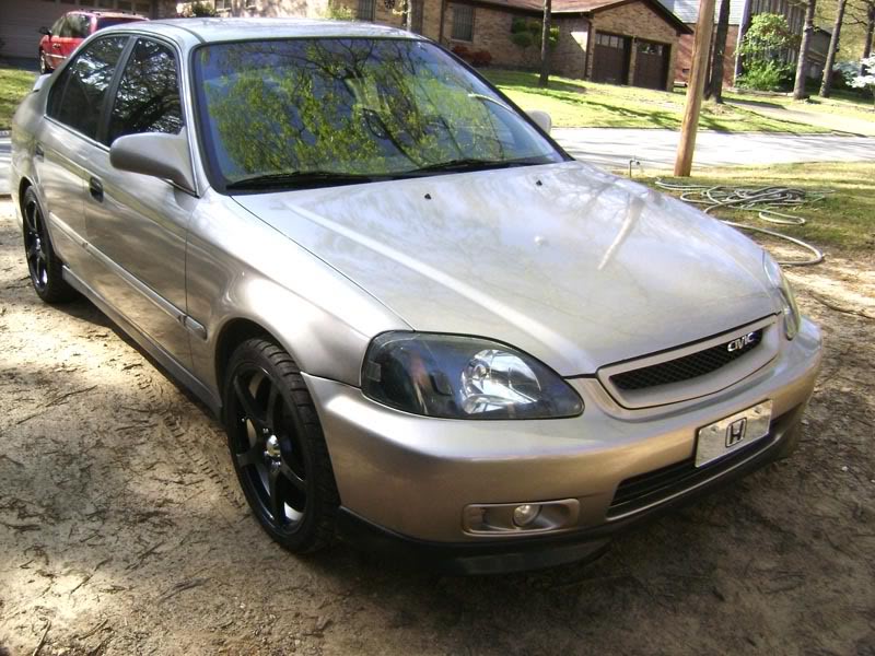

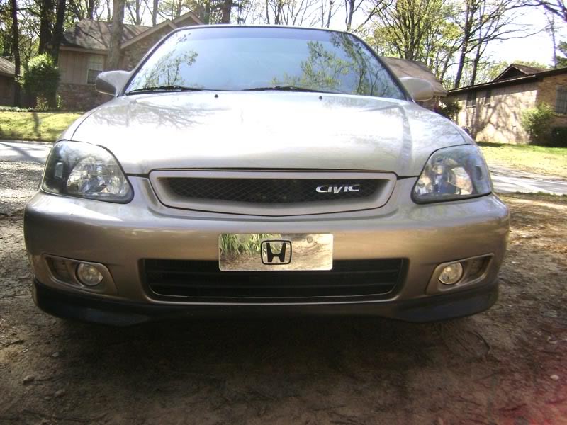

I resealed them with adhesive caulk. It's about the same consistency. And now... on the car:
I'm still lukewarm on them. They match the rims and the window tint pretty well, blend in with the upper and lower grilles alright... But I won't always have those rims. And the lips are gonna be painted this summer. Its not too late to throw and eyelid on each one, but I think I'll hold off for a bit. Wait until more paint is ordered.

Not going to lie to you, i am not feeling them. But on the bright side, the headlights match your rims.
