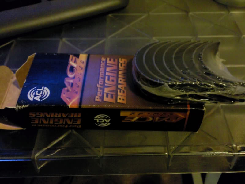

Update: The other day I found a sweet deal (no pics yet) on a Whiteline EG6 20mm Rear Sway Bar with poly bushings and collars on CL for $50! Its baby blue with yellow lettering. I think I'll like the contrast of colors under the car but I had to order some endlinks. I got Blox adjustable ones, they should be here sometime this week. The bushings are brand new but didn't come with the bracket that holds them around the bar and that bolts to the subframe. Wonder if an auto parts store would carry something that would work? Maybe ones a little large just for temporary?
Other than that I got my Password:JDM front and rear license plate frames and ACL Rod Bearings. Still waiting on the main bearings so then I can pay for my stuff at the machine shop and put the block together.
I also ordered a Type R style shift boot from Password and some new HID bulbs since the new headlights use a size H4H bulb instead of H4.
Pics of the stuff I got:

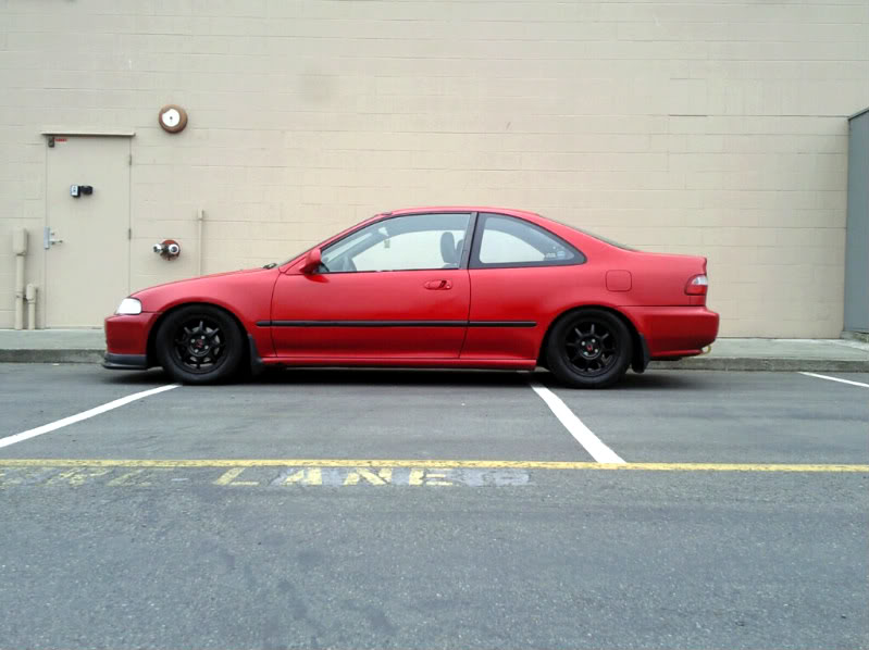

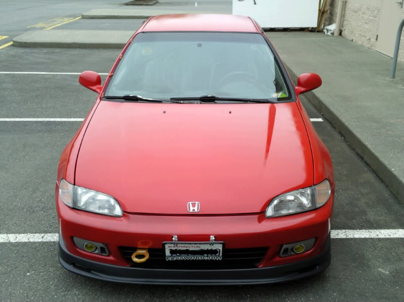

Couple pictures, had to take one for ROTM.
