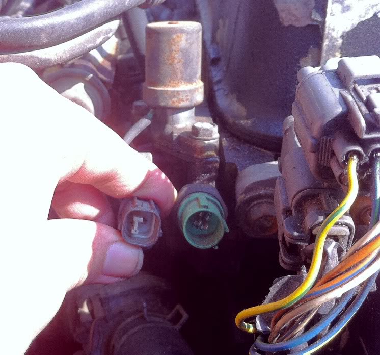

Im guessing that this is it?

few more questions..
1. which wires are what in those plugs? (3 wires total)
2. looking in the engine swap section in the vtec conversion sticky... it looks like there are other wire that need to be wired in to the new (or chiped) ECU. Where are they coming from (i.e. physical locations)

I think one of the wires in the green plug is just a ground (read that somewhere) just not sure which

ok, im getting the new ECU in tomorrow (along with new windsheild washer nozzles. i hate the stock ones)... what pin is what on the green plug in the pic... i know one goes to the ECU and the other is a ground, but which one? the plug ic connected directly the the solenoid, so i cant see any wires... also, is there anywhere i can order the plugs that go in there and just run wire from there? Junk yards arnt an option (no Civics)

Dropped in the p28 and wired up VTEC and no CELs ^.^ Not quite sure its kicking in though... this weekend I may wire in a LED to the instrument panel for a VTEC light. Stopped by a body shop and got an estimate on fixing the trunk damage. That moved up in my priority list after the last time it rained... i though the trunk leaked on just the one side, but it leaks on both.... it got my amp wet >.< Does $300 sound about right to fix the damage shown in the pictures?
