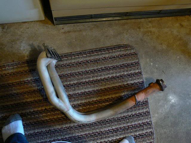

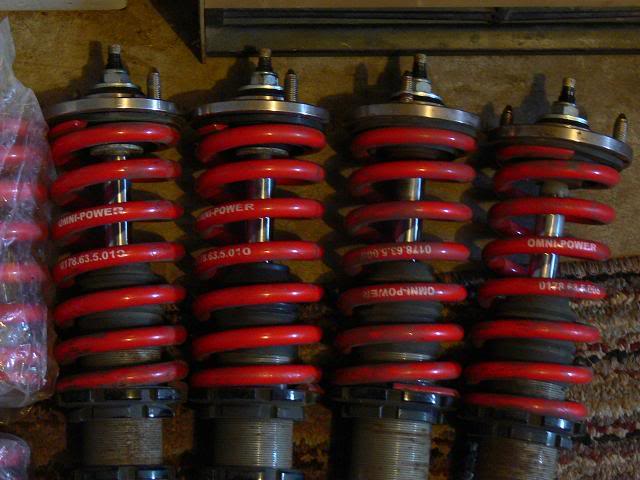

Got any pics of the car and the parts yet? Pics or it didn't happen!
Old Nov 11, 2008 | 01:41 PM
xsteinbachx's Avatar
Joined: Aug 2008
Posts: 884
From: Victoria, BC, Canada
Ask An Ye Shall Receive

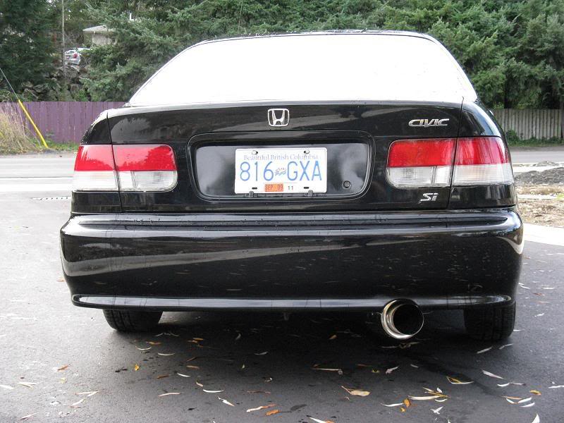

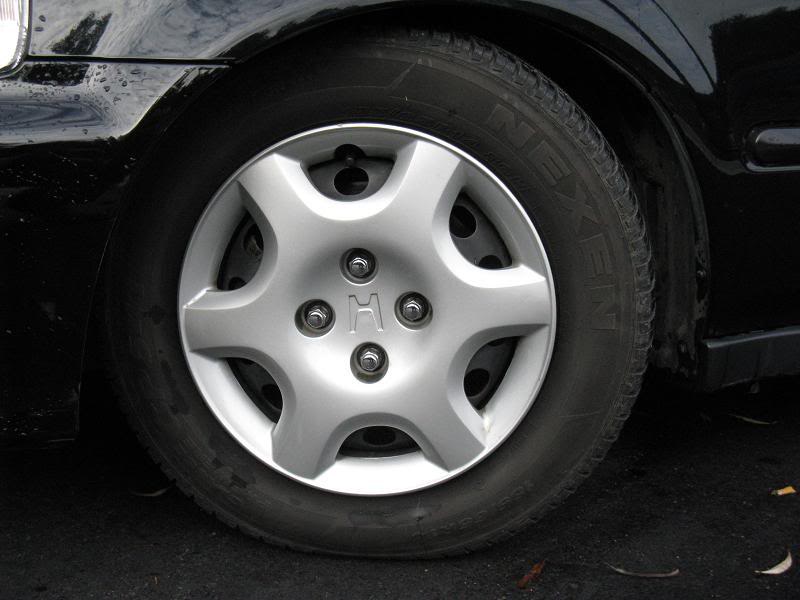

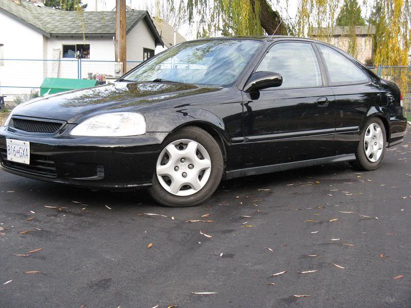

Front Tires

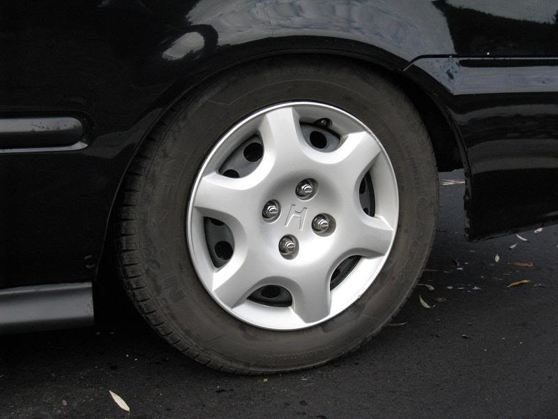

Rear Tires
Old Nov 23, 2008 | 12:16 PM
I have never seen stock wheels with hubcaps look so good. Definitely get some new rims eventually, but those look a lot better than they did. Don't forget to check the nuts holding the header to the head every couple days for the first week you have it. You'll need to re-torque them. After a couple times of checking/re-torqueing them they should be fine.
