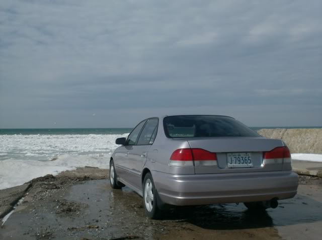

All sedan tails are the same in that they're larger. 96-98 is one style, 99-00 is the other style. But both are still that larger kind.
All coupe tails are smaller than sedan tails. But I believe they're the same, 96-98 is one style, 99-00 is another.
I have some 99-00 ebay ones that have held up okay over the years, red/clear style. They occasionally need to be resealed.
If you have a 97 sedan and you want the red/clear style, you want to source some Canadian Acura 1.6 EL outer tail lights. They are red on top, clear on bottom, a direct bolt on fit, and are clean as hell. The Honda Domani tail lights are the same, but that's Japan only and much more expensive.
Here's a picture:

Yea mine has a crack to damn I hate those

I like those! and i have been researching a Domani front end conversion because no one around here has ever seen one and although i shouldn't slam where i live but half the people here are to stupid to know what a jdm, or cdm or edm car is. But i digress, lol, when switching to those tail lights im assuming the outside ones are a direct bolt on?
Then what about the inside ones? The ones on the EL are different shape... is the trunk lid swapabble? (is that a word?)
Thanks for your input!

The outside ones are a direct bolt on. The trunk lid is a direct swap and yes, the inner tails are different. But the outer ones blend seamlessly with the USDM inner ones. I was gonna do the swap and had the trunk lid in my hands, but UPS decided to drop it off Niagra Falls on the way to me, so it was destroyed...

Ahhh i just did a little googling, because it wasnt clicking for a second but when i bought my car it had some busted a** altezzas on the back.... so the whole oem tail light thing i was oblivious to. If i had the stock tails i would have red and clear on the inside and would just have to replace the outside ones. I get it now.... gee learn something new every day.
