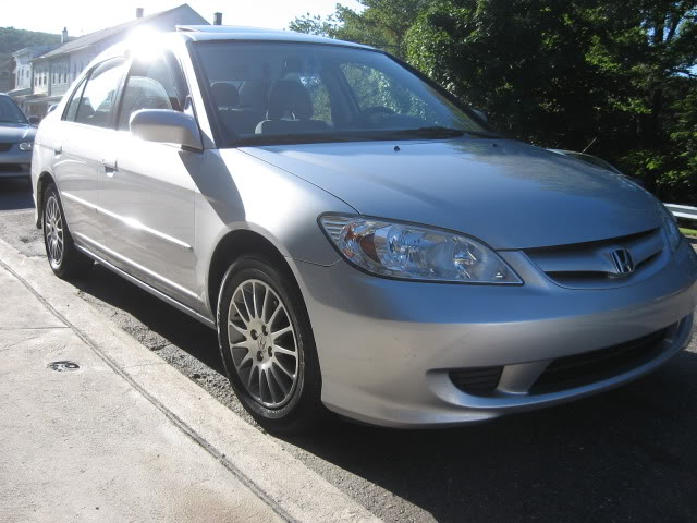

My girlfriend's car has these 2 holes in her front bumper that look like there should be fog/driving lights in them. Instead there's 2 plastic pieces that look to me like theyre removable.
My question is, does anyone know if thats what those holes are for?
Ive found some on ebay that look like they'll fit. Has anyone done this before?

if its anything like the 99-00 civic's you need to use a dremel and cut it it out. If it is an original bumper there should be a template on the back of the bumper on where to cut.
I have an hid kit from ddmtuning.com . Good pricing and quality is pretty good as well.
edit: just found this DIY. check it out http://www.handa-accessories.com/civic/05fogs.pdf

Ok. Its definetely a original bumper. I'll put it up on ramps tomorrow and looks for sure to see if theres templates on the back.
