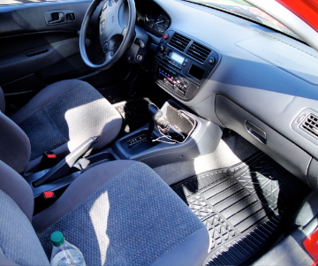

Just bought a 97 Honda Civic Hatchback (red). I'm going to replace the headliner, door fabric and sun visors this summer (thanks to addiction's diy) and am thinking about painting the trim (not the dash) black to match the black headliner I want to put up. I've read some about using vinyl dye instead. Any advice?
Also, how do you tint the dome light lens? Any pics?
This pic is before I got it all detailed and such. I know I know it's auto =( I'd appreciate the help anyways =)
